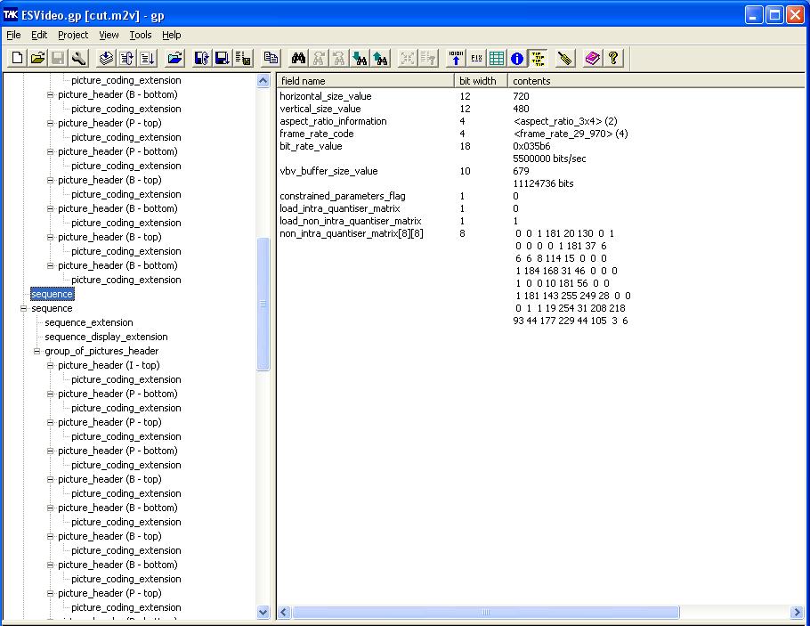

    OK, mystery solved.
    One of the sequence headers near the middle of the file has the load_non_intra_quantiser_matrix flag set, but the expected 64 bytes of quantiser matrix that should follow are missing. This causes the parser to consume the following start code elements as matrix data:
    sequence extension
    sequence_display_extension
    gop_header
    picture_header (first I field of an IP field pair, this is field structure)
    picture_coding_extension
    first slice
    Needless to say, this confounds DGIndex's parser, and some other tools as well.
    I was able to implement a workaround but I'm not sure it's worth it, given that the stream is obviously broken, and that the OP's processing of the original VOB may have caused this. The spec says that none of the matrix element values can be 0. So I look and if I see any 0's I pretend the load_non_intra_quantiser_matrix flag was not set. Obviously I will see 0's because there are start codes there where the matrix values should be.
    If this was not caused by DVDPatcher I would consider releasing it. Maybe DB83 can post the corresponding section from the original DVD. I also wonder why the patched VOB is NTSC when the original is PAL.

    Here you can see the problem in my MPEG2 analyzer. The highlighted sequence header is expanded on the right. If you convert the matrix data to hex, you see that it is actually video data.
    After posting this I see that the VBV buffer size is also suspiciously large.
    http://neuron2.net/misc/analysis.jpg
