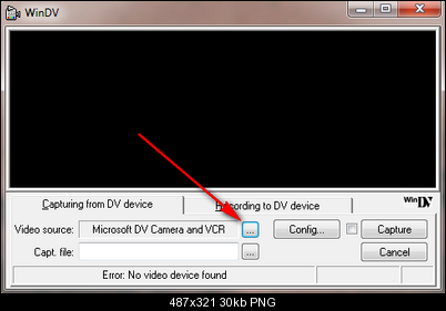

    the cam should be turned on and in play mode when you plug in into the computer. and in the cam menu settings the dv port should be set in dv out. it might help if you filled out the computer specs section of your forum profile so we had some idea what type system you are working with.
    [edit] you may need to install windv in a folder other than /programs and also run it as administrator.
    once plugged in start windv. give it a couple minutes then press the button next to sources and see if it's listed.
