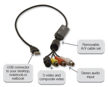

    This device is supposedly able to work in both NTSC and PAL environments but from what I've been told by Hauppauge, it's abilities are determined by the installation of the accompanying WinTV software. I'm in a PAL country so naturally I chose "PAL" when I installed the software but I also have an NTSC VCR and want to capture both.
    I have never used WinTV to capture with this device. My main capture software is Magix Movie Edit. I have tried to change the settings in Magix to NTSC but the setting either never "stick" or are "not available with this device".
    Can anyone think of a way to get this thing to capture both PAL and NTSC? I've even considered installing WinTV again as NTSC in some sort of "SandBox" type of deal but even my feeble computer knowledge tells me that is a bad idea. I've Google searched for the answer but I believe my terminology is completely wrong.
    Here is the Hauppauge answer to my question:
    Hello,
    During the software installation for the usb live 2 you will be asked if you want to use NTSC or PAL, you can choose one of them and the wintv7 program will be stuck on that mode and so if you want to use the other format you will need to uninstall then reinstall the program and select the format you wish to use.

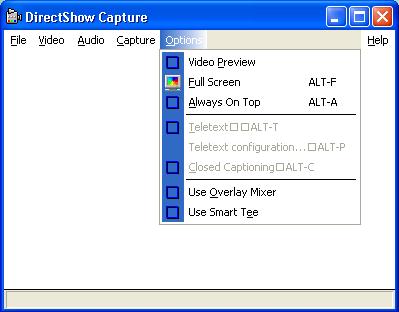

    Hello hech54,
    Try this.
    - Download WDM utils from here: AMCAP
    - Extract to any folder.
    - Run WINTV or MAGIX and select your card
    - Run AMCAP, set your card in tabs but never use preview or any filter (like shot below)
    - Go to VIDEO, signal module and select NTSC or PAL or any signal desired.
    It will change signal in realtime.
    In my old 3DFX Voodoo 3 3500 (1999 / 2000) always work. In nowsday my new cards AVER HD, AVER HD PRO, MYGICA work using the oldest, but very functional, method.
    Try and reply
    Claudio

    When opening amcap.exe:
    Error 80004002: Cannot find VCapture:IAMStreamConfig
    Try new AMCAP (9.20 - trial)
    Claudio

    Still nothing. Blank screen in Magix and no NTSC options.
    I go to my home. There will make some tests.
    Maybe not work in WINTV or MAGIX. Try VD or VH CAPTURE.
