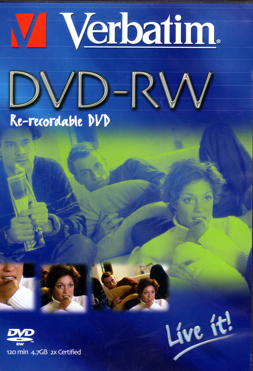

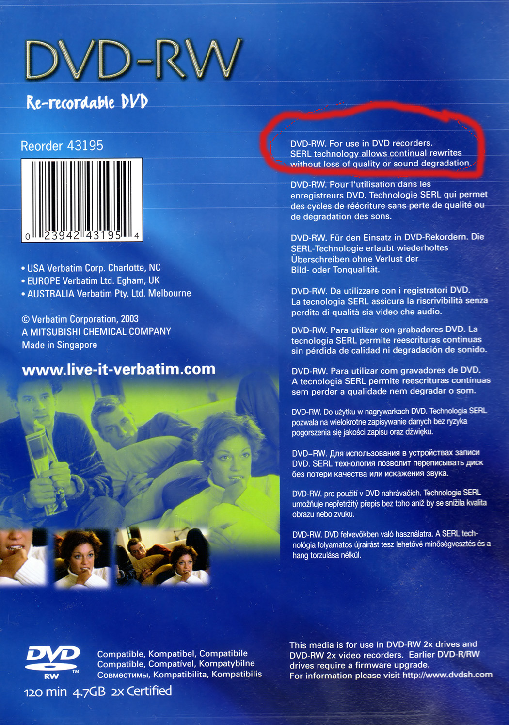

  15. This is what you want
    interestingly the Europe verbatim branch is in UK
Name:	verbatim 002 copy.jpg
Name:	verbatim 001 copy.jpg
