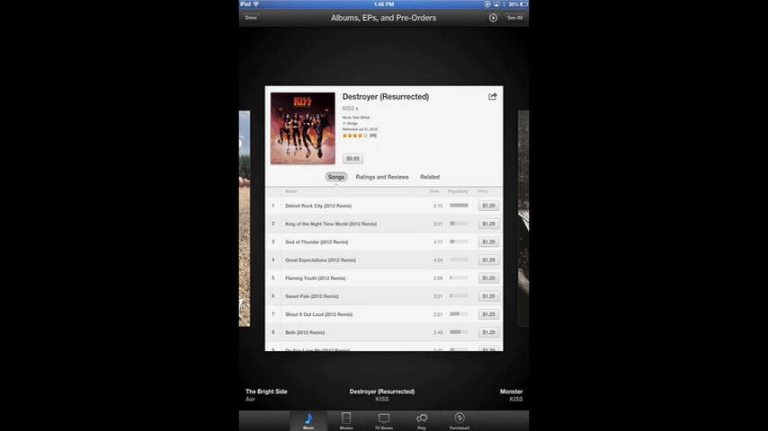

    here's the video2.mpv screenshot. it's not as clear as the original as any rendering causes losses in quality.
    i didn't resize it at all, i let vegas do that when it rendered to mpeg2. i didn't save any of the others. there isn't any way to make them clearer going from highly compressed mpeg4 to mpeg2. you would need a way to do your screen captures in dvd spec mpeg2 or an uncompressed/ lossless codec like huffyuv to make them better.

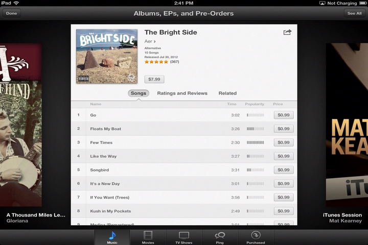

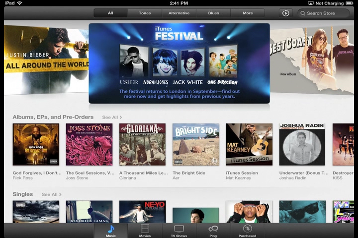

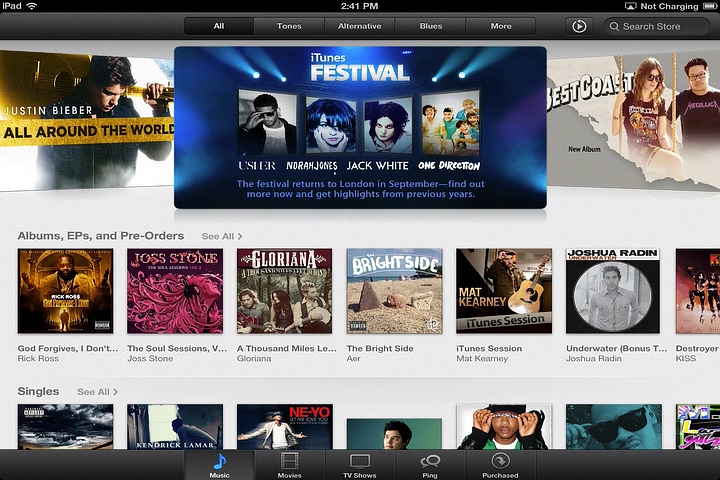

  23. This is done approximately the same way, but he's used slightly different resizing (based on 704px width + pillarbars , instead of 720px width - don't worry about the details, but there are ITU and non ITU resizing methods, but it's a fairly big "geeky" topic)
    Also, it's not sharpened , and he's converted it to 23.976p with soft pulldown flags
    He's also used 16:9 flags instead of 4:3
    Here are the non-PAR corrrected (1:1 screenshots, not with the aspect ratio correction)

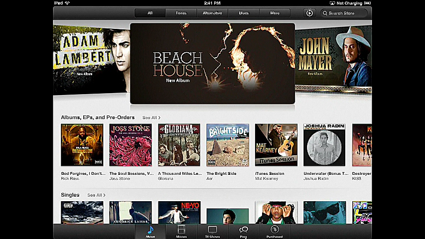

    Here is the non PAR corrected (i.e. 1:1 screenshots) of what it would "portrait" would look like (and for comparision "landscape" although it' s isn't the same screen you get a rough idea of "legibility" (these are non sharpened):
Name:	landscape comparison.png

    I'd like to demo it in Portrait mode as you said it looks better that way. But you think that the text will not be legible at all in that format? I spoke with my buddy and what he explained to me is that he's taking everything at 1440 x 960 size (background / hands / and the video's)
    What I cant understand is when I take the 640 x 960 video and resized it to 50%...on the pc this looks fine and legible and is 320x480...so if we put that on to DVD how would it get distorted to the point where the text is not readable? This would fit well in the ipad frame that we have.

    Small text won't be very legible on a DVD. Period. Did you look at post #24? That's without the ipad frame (just the screen) so it would actually be smaller than that (and if you have motion, the model moving it around, it will even be smaller)
    All ipad generations are 4:3 width:height when in landscape , they use "square pixels" so the AR is 1.333. If you rotate it 90 degrees to portrait, it's 3:4 width:height or the AR is 0.75 . Sure, the newest gen ipad has higher resolution (2048x1536), but the AR is the same (2048/1536 = 1.333). DVD only uses 4:3 and 16:9. That's it. DVD's don't use "square pixels" so the stored image is actually distorted. When playing back, the image is "stretched" back so it looks "normal" . Above I posted "non PAR corrected" images - this means the images are shown as they are encoded and stored, not in the aspect ratio that they will be seen.
    The "square pixel equivalent" for a 16:9 DVD would be 854x480 (the 720x480 is "stretched" to those dimensions), thus everything is the proper shape (circles look like circles, people don't look too tall & skinny or short & fat) . Of course when preparing the DVD, you have to know all this (square pixels, PAR corrections, I'm sure your friend knows all this) So I posted the PAR corrected portrait example below, can you read the text clearly?
    You can design your video to get around these limitations (e.g. use content with larger text, show only parts of the ipad when text viewing is critical) . I don't think text is very legible when you show the entire screen, certainly it's worse than landscape when you force it to fit DVD's limitations
