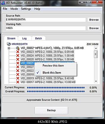

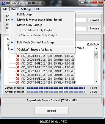

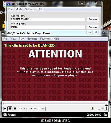

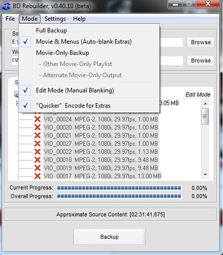

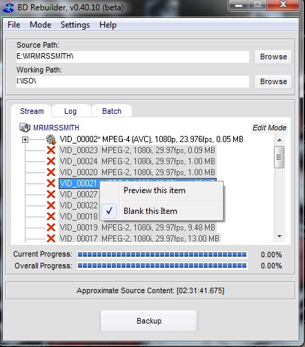

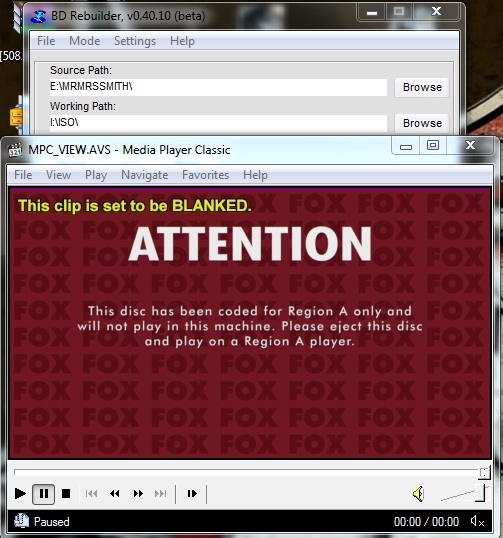

    Originally Posted by fritzi93 View Post
    Yes, there *was* such a program.
    In BDRB, v0.39.7, you could add to the config file: ENABLE_TEST=1. This would unlock a hidden option to selectively blank items on the BD. You accessed in under "MODE". You can download that version and maybe get it to work by changing the date on your computer to January 1, 2012
    I was wondering earlier when I read the first post's why no one mentioned that.
    I am using v0.40.10 (beta) and the function is still there.
    I added the ENABLE_TEST=1 quite a few versions ago and just updated as new versions came out and it was always still there.
    I have v0.40.11 but I have not updated it yet.
    Maybe just updating the older versions does not remove or overwrite the config file/ini
    Just preview by right clicking on each vid to see what you want to keep and what you want to blank/remove then select.
