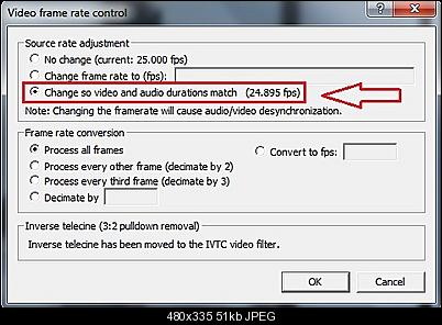

  11. OK this settings:
    slove the problem
    The question is if this is true.
    What do you think?
  12. Banned
    New York, US
    Yes, I know "Change frame rate" is there. Your video is slightly off speed. To be exactly on pitch, it would be 24.976 fps. Because I almost always make basic corrections in Avisynth to start (I capture in AVI, not in DVD), I would have corrected it before going to VirtualDub.
  13. Originally Posted by sanlyn View Post
    I did not understand what your "yes" means..
    So it still not right or it is right?
    If it is not right, then what should be done? Repair time audio and video time together?
    this is pal and not ntsc(If it means something)
  14. Banned
    New York, US
    I mean yes, I am familiar with the "Change frame rate" control. If the adjustment works, use it. I haven't used it, so I can't advise.
