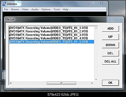

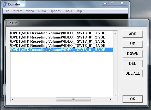

    First, i put all the VOB into DGIndex software:
    Then, DGIndex connected all video files to one video.

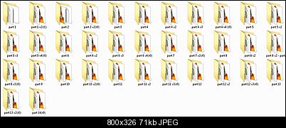

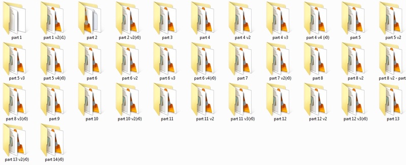

    Then I cut small parts from the video to this:
    (I created the folders and that order)
    This simple idea came into my head ..
    I just think a lot more correct to work smaller parts.
    r0 - it means that this part is from the first recording(first DVD disk).
    v1, v2 ... - This means that it is the same section of the tape but which recorded again.

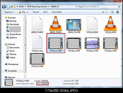

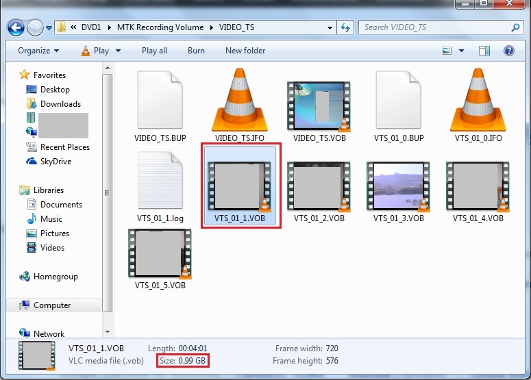

    B) When you say that the VOB is 1.99-GB, I think nyou mean that if join the small VOBs into one m2v file, the m2v is 1.99-GB . Is that how the number "1.99" was derived?
    Each VOB file really weighs 1.99GB.
    here Is a picture:
    Windus also writes that this VOB file has only a few minutes.
    so it really happens even with VirtualDub - I see only a few minutes of the video in this software..
    But it is wrong.
    I just checked only this VOB file in DGIndex and saw that has a lot more than 4 minutes ..
    Not for nothing that weighs 1.99GB.

    now when I look at the picture, I see I was wrong.
    Each VOB file weighs 0.99GB..
    I was wrong.

    Also notice that the images above show the file names, but no other information. The image below shows more information of the VOB files that I copied to my hard drive from a DVD recording that I made. The files in RED are files that I selected with the mouse:
    [Attachment 13391 - Click to enlarge]
    The 4 files above the VOBs were created by DGIndex. The file "ALL_VOB.d2v" is the first thing I created with SGIndex. The d2v is a project filoe created by clicking "Save Project". The d2v is an index to all of the joined VOBs. True, there are sections of video inside the project taht I might use or might discard, but the d2v is an index to the entire video.
    The next thing that I did was to demux the video for only one of the VOBs. That file was "VTS_01_1 T80 2_0ch 192Kbps.ac3". The file name reads "ac3 because this DVD was recorded with AC3 audio. Your video used mp2. mp2 is OK for PAL, but many NTSC players don't recognize mp2. PAL is different.
    Creating a separate mp2 for each m2v cut is likely the source of the playback problems. In any case, it would be better to open the d2v project, and then demux audio for the ENTIRE group of VOBs -- that is, a single audio demux for the entire video. This audio file will be much smaller than the joined VOBs.
    If you want, you can make an m2v of ALL the VOBs, instyead of a d2v. The size of that m2v would be near 4-GB. But that would be a waste of space because you are cut the m2v into smaller pieces anyway, so much of the m2v would be discarded. Besides, if I were cutting a video into pieces to be repaired or to perform color work, I would break the video into small AVIs and imbed the audio into each AVI as uncompressed PCM audio. This would avoid quality loss which occurs by processing with mp2 or ac3. Besdies, PCM (a .wav file) is universally recognized by most applications. In the end, you will have to join your smaller cuts together into a single MPEG2 to make a DVD, and the audio could be re- converted to AC3 or mp2 with very little quality loss.
    I see that you created a demuxed mp2 audio file for the entire video. Likely, you should join the audio and video BEFORE making cuts. If you do so, the audio and video will stay together for each cut. poisondeathray proposed one way of doing it. There are other methods, but the script requires that you download and install ffmpeg codecs to use mp2 audio. If I found myself hemmed in by a video that did not use audio I could save as a .wav file, it would simply make the process more difficult and complicated.
    Wait a short while. I am converting the audio in my sample VOB project from Ac3 to mp2. Will return shortly.
