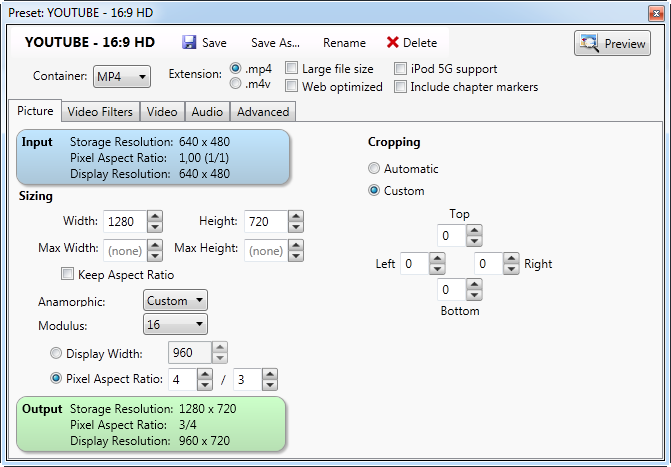

    I've just noticed 1 little problem here. Because the resolution of the opening screens and menus of the game are all originally 640x480. Is there a way I can Mux it with any other of my 1280x720 and force that video (video00.avi) to stretch to 1280x720?
  14. Originally Posted by AnotherFRAPSuser View Post

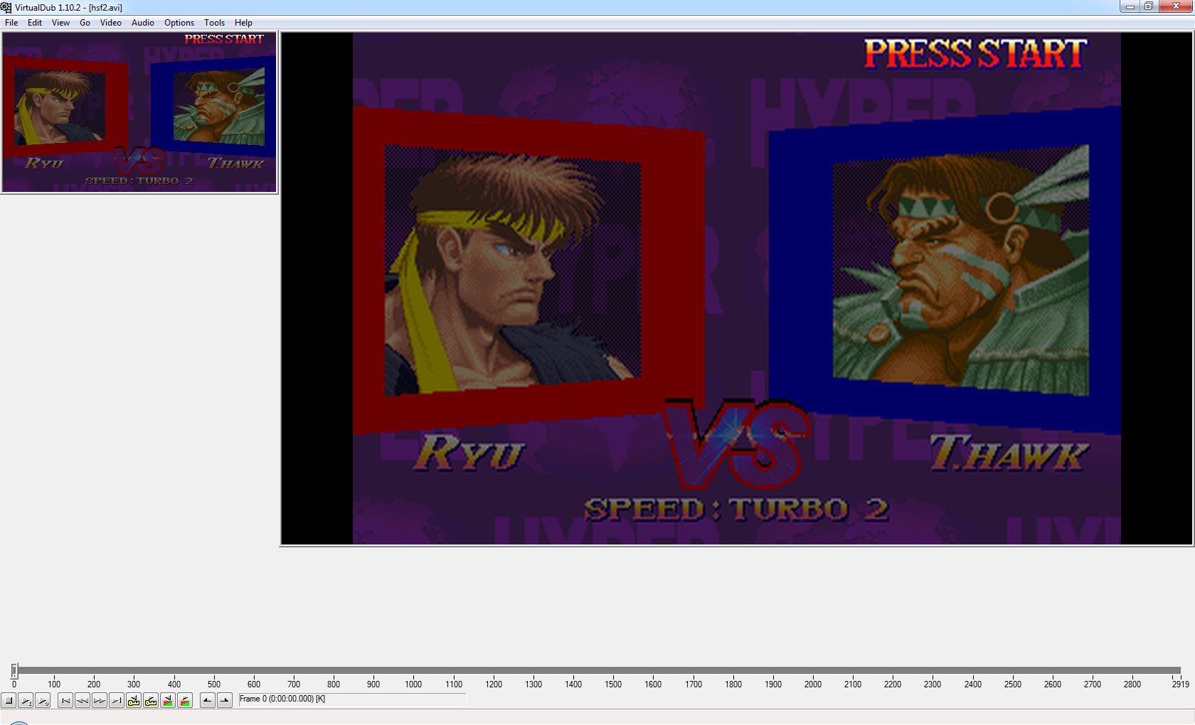

    It's also the wrong aspect ratio 4:3 vs. 16:9 (Even if you re-encoded it and upscaled it, it would need to be pillarboxed to keep things looking normal)
  15. Originally Posted by poisondeathray View Post
    No .

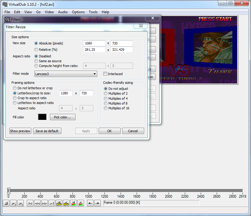

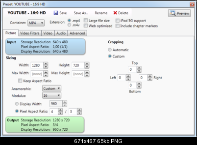

    How to I exactly apply this pillarboxed but leave the rest of the 1280x720 video alone when muxing them together? Can any of the editors mentioned above do this? More specifically VidCoder?
  16. But you're not leaving it as fraps, so it doesn't matter (I don't see what you're asking about leaving the 1280x720 video alone? Because you're re-encoding that to a lossless format)
    I would do the pillarboxing and upscaling in avisynth. I don't know about vidcoder (I think it's some alternate GUI for handbrake) , I doubt it will have enough control
    4:3 within a 1280x720 frame is 960x720 (that's the dimensions the 640x480 is upscaled to), then pillarboxed with 160px bars Left and right each (160+960+160 = 1280 wide) that way the aspect ratio looks right and nothing is distorted or stretched

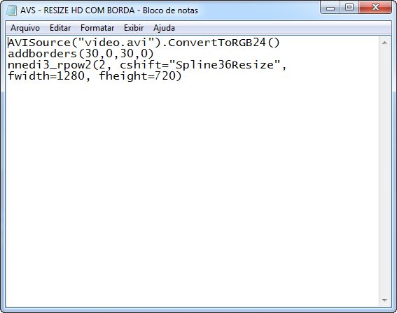

  17. Lone soldier Cauptain's Avatar
    Jan 2006
    Brazil
    Its simple.
    Claudio

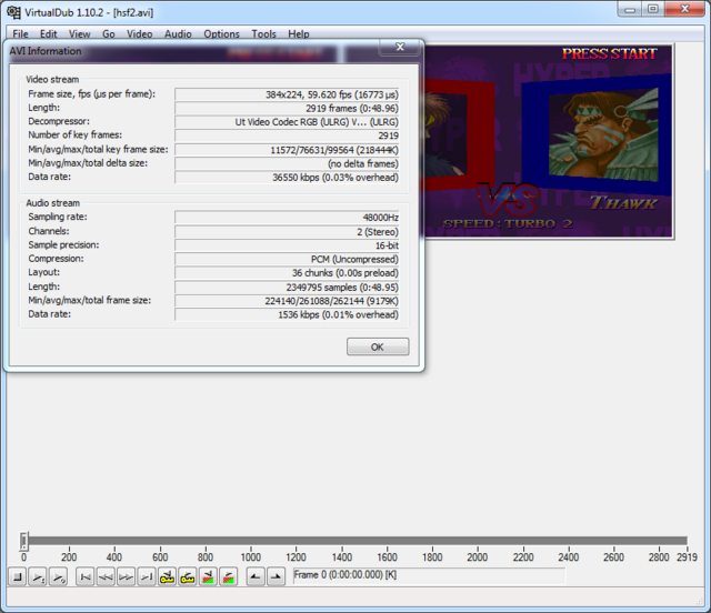

  18. I realize there is another problem. I realized that I should have mention this when I first started this thread.
    Since the videos were captured on an older version of FRAPS that had not support capturing a single video file that is output over 4 GB each, all of my videos are split into 3 to 6 chunks of AVI files.
    And VidCoder does not have a way to Mux ot merge those AVIs when I convert them, maybe I am missing something. Because I don't see a Join Videos option anywhere.
    Will I need another converter that can apply what VidCoder does for converting AVIs to H.264 MKVs and also join them into a single video file?
    If I need to use another application for this then will it be able to merge them as Passthroughs without having to re-encode them?

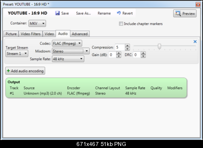

    Will the joined AVI still be using the original Fraps codec with no loss to quality?
    I asked about whether I should do 2 MKVs, 1 with the upscaled from 640x480 and the other where all the 1280x720 avis are all joined together and then use a separate MKV video joiner for them. But you said joining video afterward can be less reliable, and prone to problems and that's another concern especially if the Audio De-Synchs
    I tested a conversion via VidCoder for a H264 MKV with FLAC and it synched fine. I tried it previously using another converter called FreeMake and it has the de-synch issue, probably because it does Not even detect the proper framerate of my videos which are all 60 FPS and FreeMake sees them all as 25 FPS
