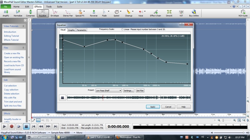

    I use wavepad and I filter out the noise in this way:
    I just play with it from what I hear.
    is there are more correct way?

    Your screenshot shows a low pass filter. Audacity's "noise removal effect" is certainly better than that.

  9. Ok after I tried your suggestions, I figured the best thing for me is to work with the graph (like the picture I showed) and with my senses.
    I do not think there is a filter or plugin smarter than me
    My best settings:
    [Attachment 13400 - Click to enlarge]
    EDIT
    Ok I've succeededto find the specific point with the noise ..
    [Attachment 13401 - Click to enlarge]
    Does anyone is work this way?

    Sounds like you're just filtering using graphic/parametric EQ. Not a bad way to do things, but that only gives you static adjustments. Lots of extra help can be given when EQ is applied in different ways to different dynamic/volume levels. Plus, there's things that can be done with phase, pitch, delay that can come in handy as well.
    That means that a filter/plugin may not be more discerning than you, but by being more exacting, and more manipulatable, it can be more responsive than you, and in many ways that translates to being "smarter".
    At this point, it's probably your experience (or lack) that is getting in the way of it sounding better. But if that's good enough for you, then great!
