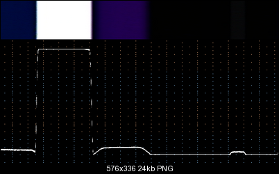

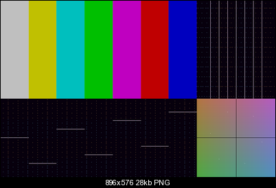

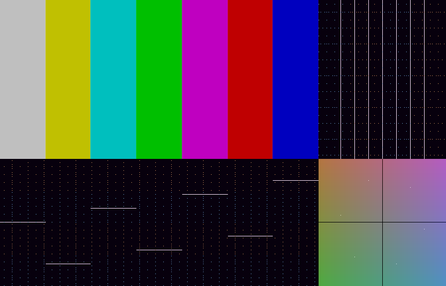

  24. Yes, adjusting colors is very difficult in RGB. It's best done in YUV. Here's an idealized vectorscope graph of the colorbars (lower right corner):

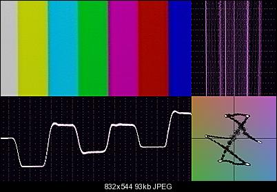

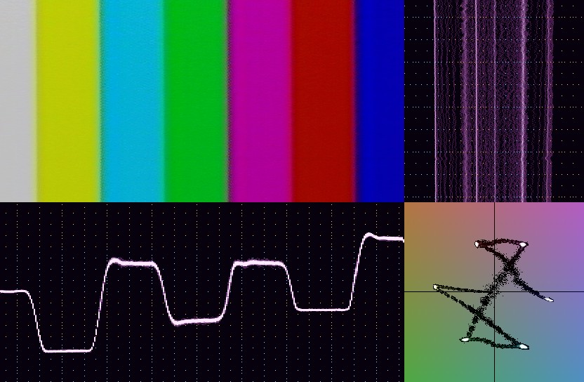

    And from your last image:
    The vectorscope from that image with the ideal locations marked:

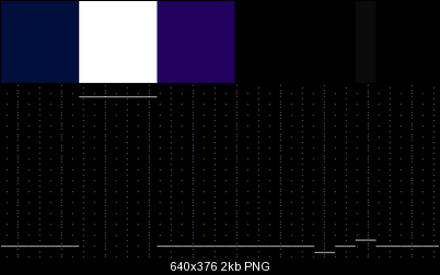

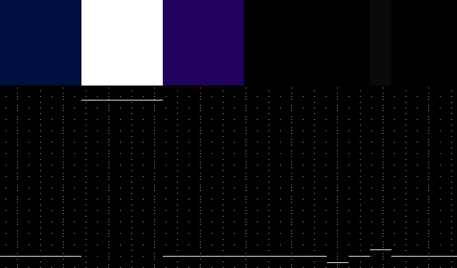

    The waveform monitor levels graph, ideal:

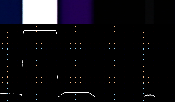

    And from you last image:
    Those were made with the VideoScope() filter in AviSynth.
