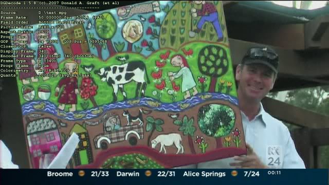

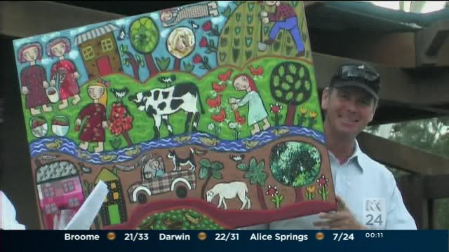

  20. It's not so much a case of detail being lost or blacks being too black, more a case of the colors looking a little "off", but because of this the overall picture can look a little darker.
    Here's an example of the color difference. I still had these saved from when I first started converting HD to SD and posted in another forum trying to work out what was going on. I think the first one is how the picture should look. When the colors aren't converted correctly, reds and blues tend to get darker, while green gets brighter (I think). Anyway, this is the sort of difference you might see. Try loading each pic in it's own browser tab and switching between them.
    If you look at the guy's face, you'll see it looks a little darker in the second pic. It's not a huge difference in this case, but sometimes the effect can be quite pronounced. And yes, you can still use the color conversion template to correct the colors when re-encoding.
    The overall black levels though don't really change, so if you've got a problem with blacks looking too black, it's possibly a levels issue. That's not normally something you have to worry about when encoding but sometimes you need to fix it on playback.
