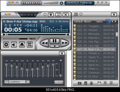

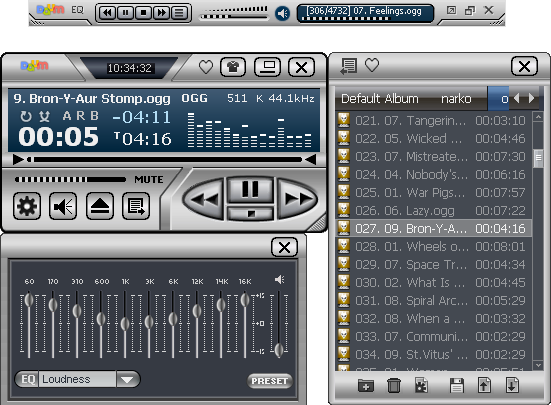

    AceNeat_Final Potlayer Skin by OzZY1 / Bulgarian, English and Russian interface
    http://www.mediafire.com/?aw9jwk44brovq03

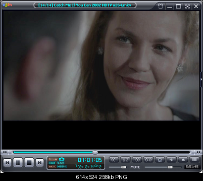

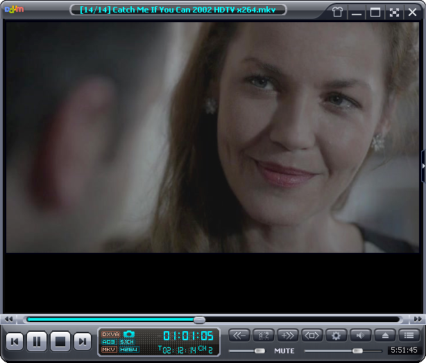

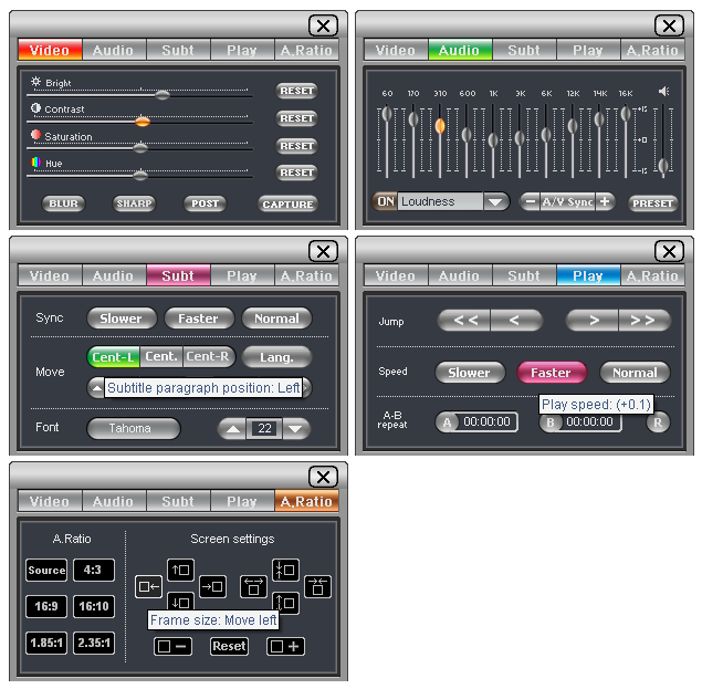

    my new skin ZebraSilverPlus / En-Ru Interface
    download: http://www.mediafire.com/?7h47zpvjmipwmr0

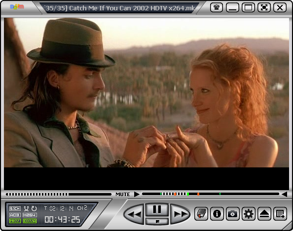

    A New Year with new skin : ArcaneDark by OzZY1
    Russian and English interface / Download from link:
    http://www.mediafire.com/?1idkdr04i9f30cz
