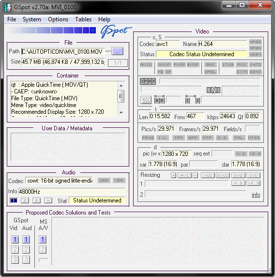

Sup. I want to do a few things with a MOV I recorded with my camera (Canon SX130 IS), but CS3 isn't compatible with that format.
The file looks like this:
https://forum.videohelp.com/images/imgfiles/tyQxg.png
What format and conversion program would be the most suitable? I want to preserve as much of the original quality as possible.
Another question - is there another program like GSpot that displays all the important info about video files or is GSpot still good enough?

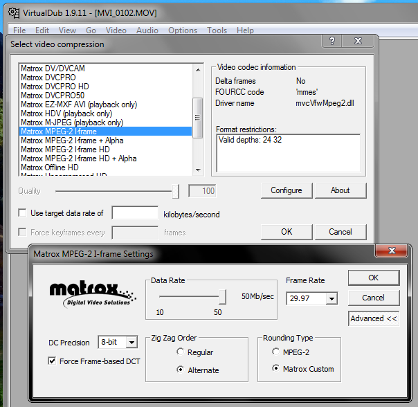

So I experimented a bit more and figured out what works and what doesn't. To be honest, the digital camera I'm using is rather cheap, so the clips it records aren't very good quality. I'm saying this because the profile and advanced settings may be important when I get a better camera in the future, for instance.
Can you explain in layman's terms which one of the following is the "best"?
DVCPRO HD
MPEG-2 I-frame HD
MPEG-2 I-frame HD + alpha
Uncompressed HD
Uncompressed HD + alpha
I'd also like someone to suggest what I should set the following parameters to:
DC precision (8,9,10,11-bit) - I read a bit about it and supposedly 10-bit is optimal. Is that true?
Data rate (10-50 Mb/sec) - data rate = bitrate, right? How much would you suggest?
Zig zag order (regular/alternate)
Rounding type (MPEG-2 / Matrox custom) -
"best" in terms of what?
best quality is uncompressed, but also largest filesizes
"alpha" means alpha channel , only if you are using compositing (things like green screen) so you don't need those options
10bit is optimal
data rate - higher is better quality, larger filesizes (filesize = bitrate x running time) . You might be using the wrong option because 10-50Mb/s would be for SD. I think HD options go in to the 100's
zigzag is usually for progressive, alternate for interlaced - these refer to the block scanning order
I don't recall what rounding type is (and I don't have matrox installed on any of my computers) -
50 is the highest setting when I use Vdub. I dunno how I can set it to more, maybe using text commands or whatever? It's all so complicated!
Screenshot:
https://forum.videohelp.com/images/imgfiles/nWzJb.png
