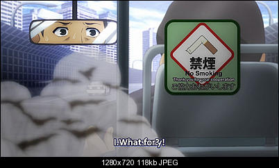

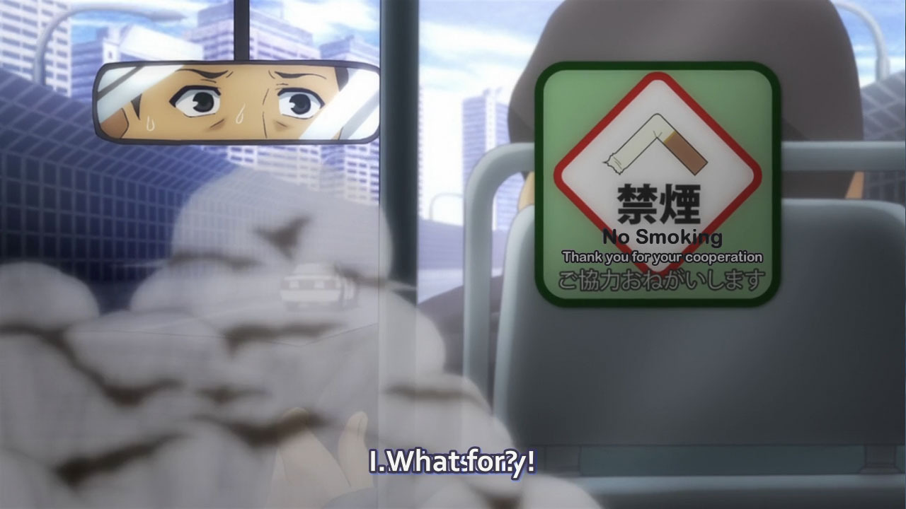

An example of an overlapping sub:
This is from a recent burn-in I did a week ago. The subtitle is displaying the older dialogue along with the newer on top, plus it's also displaying a sign for "No Smoking". I've checked the subtitle file and the dialogue parts are meant to display from 22:55.39 to 22:57.23 for the first line "I... I'm sorry!" and the second displays at 22:57.43 to 22:58.69 for "What for?". Two lines .20 of a second apart. The only thing the two lines have in common is the "No Smoking" sign being displayed at the same time they are. I first thought that that was the issue. Handbrake was having trouble with dialogue lines when signs were also to be displayed, but I think I can conclude that that's not the case because signs and other dialogue were playing through the entire video and others that I've done that have called for lines to play with overlapping times.

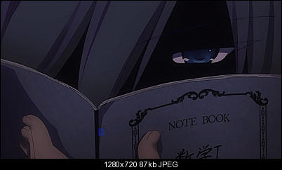

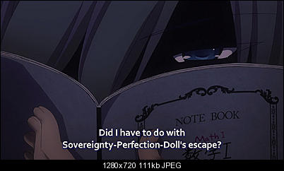

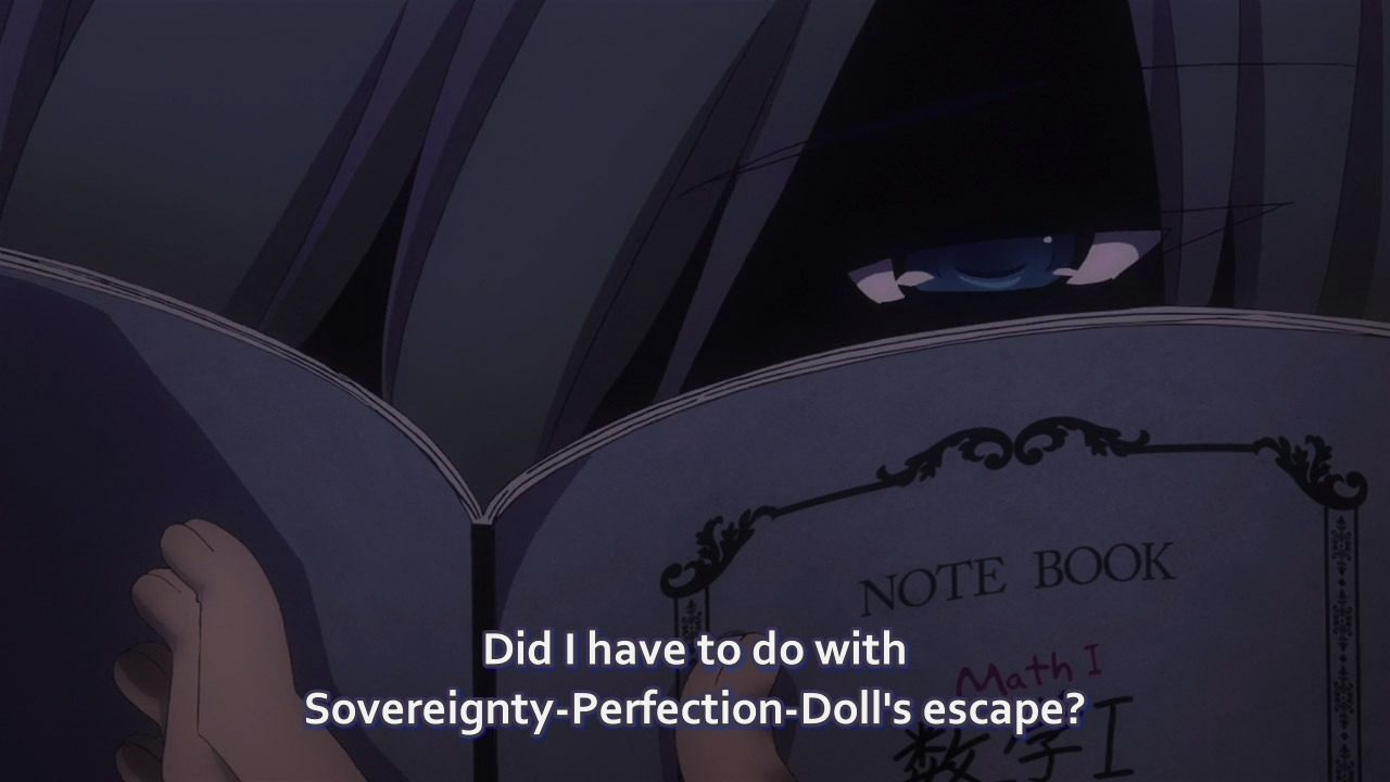

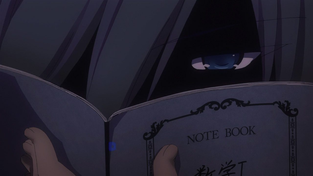

This next example is a fairly rare issue I've come across and that's disappearing subtitles and signs:
Now you see it:
Now you don't, but you do see a little blue "D" from the background of the first word.
The issue has come up quite a lot with previous videos done with Handbrake, but it only ever did it with signs. They would display for half a second then vanish and pop up again just before their time to stop would come. That's what it's doing with the subtitle in the above images. It's displaying at the beginning of it's allocated time, vanishing for the duration, and only reappearing as a flash at the end of it's time. The burned in background of the letter is a new thing though just for this series of videos that I've done. I've yet to see it on more recent ones, but I'm sure it's there.
