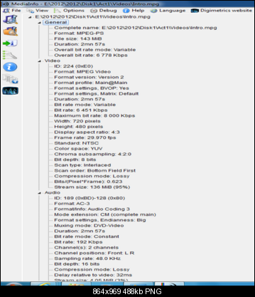

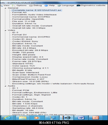

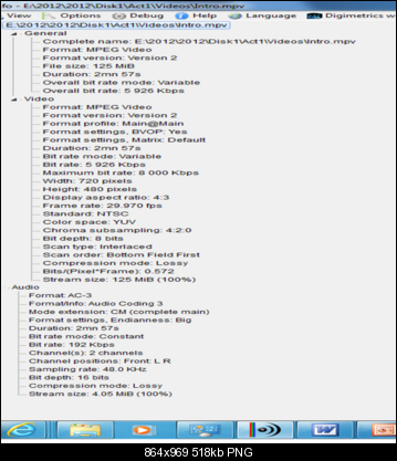

    In order Labpro output, premiere output, and Original which is larger because its uncut and more footage...

    Looking at the mediainfo reports, I might suggest you upload the two edits so that we can take another look.
    The other thing you could do is rip the menu track from the final dvd and also upload that.
    They certainly appear to be dvd compliant and no re-rendering would be required. All dvd authoring programs re-render for menus but with complaint video there should be no effect on the quality.
    One thing I did notice tho is that the original DV is BFF which is correct. I would always encode the mpgs as TFF.
