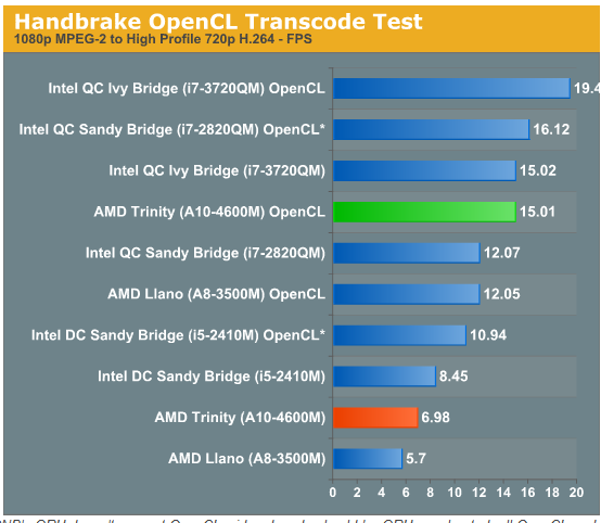

    it looks like the guys behind x264 have managed to accelerate portions of the popular, open source h264 encoder using Open CL:
    http://techreport.com/articles.x/23324
    What happened to those OpenCL-accelerated video encoders we were all daydreaming about? Well, they're still in the works, believe it or not. The folks behind the popular x264 software encoder have been quietly plugging away at an OpenCL-accelerated version of their lookahead pipeline. Lookahead only accounts for 10-25% of the total encoding time, according to x264 lead developer Jason Garrett-Glaser, but the process allows for nearly unlimited parallelism and is relatively easy to implement in OpenCL. Re-writing all of the x264 encoder in OpenCL, by contrast, would be "very hard." Garrett-Glaser says the accelerated lookahead can increase performance by up to 40% on AMD's new Trinity APUs and by a factor of two on the latest Radeon graphics cards.
    it's a start...
    edit: i ran across this article while googling for more info:
    http://www.anandtech.com/show/5835/testing-opencl-accelerated-handbrakex264-with-amds-trinity-apu
    i can't wait to test it out with my quadro 600
    second edit: i found a test build:
    http://astrataro.wordpress.com/2012/05/17/x264-test-build-with-opencl-lookahead/

  9. It's generally accepted that "regular" GPU accelerated encoding sucks. At present, you can't accelerate the whole encoding process without impacting quality. I think what the x264 team are trying to do here is only accelerate the portions of the encoding process that would have little or no impact on quality.
    Even a 10-20% increase in speed over the original x264 would be better than nothing.
  10. Actually they are re-coding the parts that allow for nearly unlimited parallelism. EG the easier parrts to recode for OPENCL. I presume they will still expect the same quality. Its not hardwardware bad software good, it just happens that, so far, hardware encoding has been a poorly written, one off the wrist, piece of Programming's.

  12. Originally Posted by mh2360 View Post
    Probably more like 5 to 10 percent (40 percent of 10 to 25 percent). Either way, nothing to get excited about.
