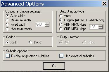

  20. Interesting. Your MP3 audio seems to be perfectly good. Is there any reason you're reencoding the audio? You can have AutoGK just use the original audio unchanged. Is it because the source audio might be VBR and your subbing program doesn't like that? Anyway, I did a test and the main change I made was in the Advanced Settings where I had it pass-through the audio, rather than reencoding it. I have no idea why it says 'AC3/DTS/MPA only since it seems to easily pass MP3 audio. You might try that.
    Are you really feeding H.264 video into AutoGK? Shouldn't you make it XviD or DivX?

  21. manono, how do you configure it so it will pass through the audio?? Sounds like a great idea.
    EXACTLY!! manono, I didnīt explain that part, but really I have 2 problems. Not just the problem with Auto GK. The problem is this: what Auto GK likes, Subtitle Workshop dislikes, and vice versa. So I need to do 2 conversions, one for SW with mp3 audio, and a new one for AutoGK with AAC or AC3 audio. Really not practical.
    I also tried what you suggest in your image about the advanced settings for AutoGK. But the problem persists. Because that is for the output sound, and the probem is the input, not the output. The problem is the videos I try to convert. This codec thing is a never ending story, and I still canīt believe that I need to use 30 different little programs and that they are all mutually incompatible from the codecs and supported formats point of view..... ((( Itīs literally exhausting... I have kept changing codecs and tried everything I could think of, but there doesnīt seem to be a stable solution.

  24. Originally Posted by Valerc View Post
    I showed that in the included picture. Just tick 'Original'.
