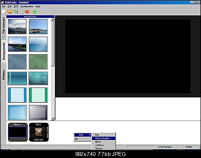

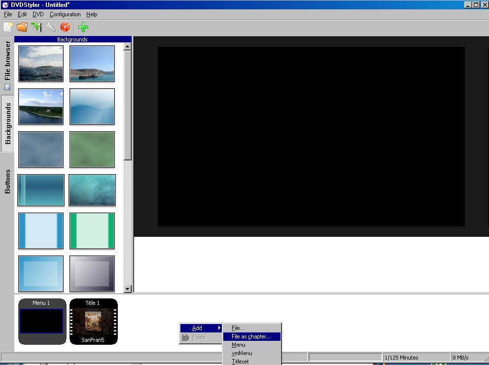

  6. In DVDStyler you may add a video to a title as a chapter
