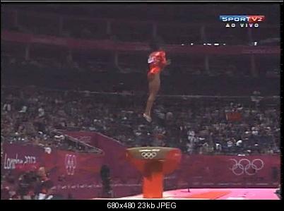

  8. Originally Posted by poisondeathray View Post
    It's done with 20-50 cameras in different positions
    Poison, are you still there? Have a look at this another sample.
    I still have some questions about what you'd said:
    1 - Why there are different backgrounds at the point that begins the effect, between the previous and post frames? It's clear that it wasn't the real-time scene, but a recorded one.
    2 - Why we can see difference of the color of the clothes (? - what is the correct name for that cloth). It was purple and became red, at the computer render)
    If it was various cameras, as you say, the image would match 100%. Or not?
    Thank you.

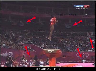

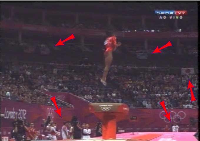

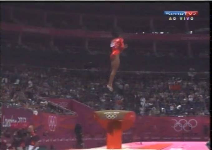

  10. Please, note that the clothes color is the same of the vault-horse (red). Bad job matching cameras is not the excuse.
    And the video was captured directly from TV. It wasn't downloaded from internet.
    Also, note the difference between frames:
Name:	Philips Carousel Effect_a.jpg
    and
Name:	Philips Carousel Effect_b.jpg
    Different backgrounds.
    Thank you.
  11. I don't know, but the cameras don't match in color (the 2 live ones, beginning and end) .
    The 1st camera might be main network camera (the ground side view with the dolly move as the athlete runs), but not plugged into the multiple camera replay system - hence the color difference . Often networks will "lease" the feed from other networks. e.g. this might be NBC's (american) camera, but the replay system might be BBC etc... So they might not have balanced or matched them. Notice the 1st camera view isn't included in the replay (where the outfit is clearly "pink").
    I don't know why the background changes. It shouldn't. They might be using a different system. 360 degree replays for sporting events are usually done in similar fashion. I don't know if it's that network or just the low quality video, but it doesn't look as clean or crisp as other events like Superbowl.
