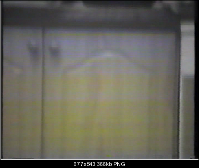

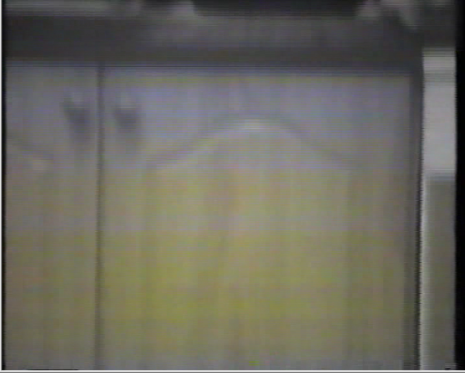

    [Attachment 13307 - Click to enlarge]
    I right-click on the BadFrames.dll, clicked "Copy", then navigated to the "Avisynth 2.5/plugins" folder in my Windows programs on Drive C, right-clicked on "plugins", and clicked "Paste". So the only thing I have in my Avisynth plugins folders are the dll's, avs, and avsi files I need. I don't need the html's, source code, advertising, etc. Here is a shot of my "Avisynth 2.5/plugins" in my C-Drive program folders:
    [Attachment 13308 - Click to enlarge]
    Anyway, it's a suggestion. In the future, though, you'll have to be careful about having multiple versions of some plugin dll's in the same folder.

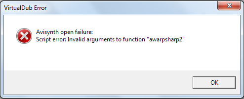

  24. Originally Posted by jagabo View Post
    to sharpen up the colors you should try something like:
    mergechroma(awarpsharp2(depth=40))
    i'd remove a lot of the chroma noise first with:
     mergechroma(mctemporaldenoise(settings="very high"))
    error:
  25. You need to download and install awarpsharp2.

    4)Is one of the filters you've given here can filter Automatically color problems As shown below:
    * This is one of the problems I'm not going to fix manually (like I did with the script) because it will take me forever ..
    It's something that happens lots of times.. It's not so that bad, but now I prefer to fix it (after seeing the forum on your filtered video)
    I would love to have an explanation of the filter (which filter makes it) and the settings used in this video.
