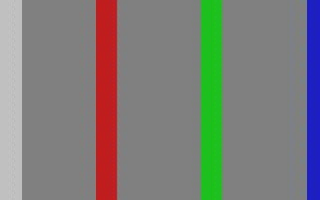

    I was asking you. It's a clear cut case of interlaced MPEG 2 video. If you saw interlace artifacts with that video your player simply isn't deinterlacing. If you saw blurry lines the player is deinterlacing poorly.
    This is what the video should look like when properly deinterlaced (frame cropped and slowed to 6 fields per second):

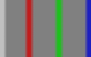

    This is what a poor blend deinterlace looks like:

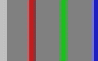

    This what the chroma upsample bug in many DVD players and graphics cards looks like:
