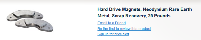

    i wasn't referring to the platters but the extremely powerful rare earth magnets that are used to move the read/write arm assembly from track to track. but even with their strength they don't effect the data on the platters, nor anything outside the drive.
