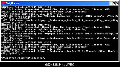

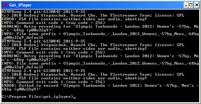

  3. I'm unable to install the windows version of get_iplayer getting the following error message "Windows cannot access the specified device, path, or file. you may not have appropriate permissions to access the item."

  9. Originally Posted by blackhawk01 View Post
    OK need specifics. What version of Windows, I am assuming this is Windows? You saved the file get_iplayer_setup_latest.exe to your hard drive and then ran it? Did you get any indication of progress before the error? Are you a local administrator on the machine and able to install programs?

    I am using get_iplayer on XP and getting good results with some oddities.
    For example I extracted Jade Jones first round Taekwondo fight with this command
    get_iplayer "http://www.bbc.co.uk/sport/olympics/2012/live-video/p00w32g9" --raw --modes flashvhigh --start 5864 --stop 6600
    the following error was returned over and over during the download -
    ...despite the errors the resulting file was perfectly fine!
    the only oddity is that VLC thought the video was 4:10:45 long (the length of the complete video) and did not recognise the cut down length of 12 mins.
    Thanks to everyone for the tips, I will be having hours of endless fun with this
  22. Originally Posted by richieboy View Post
    [Attachment 13508 - Click to enlarge]
    If you were to scroll back you will most likely have seen that the timestamp that rtmpdump stopped at, "<xx> kB / <yy> sec (zz%)", reported the stop time you requested, i.e. 6600 seconds. If thats the case then it worked fine and you can ignore the error.
    I suspect the error is from the get_iplayer wrapper around rtmpdump not seeing the download complete to the full stream duration and so retrying. This is just a guess however
