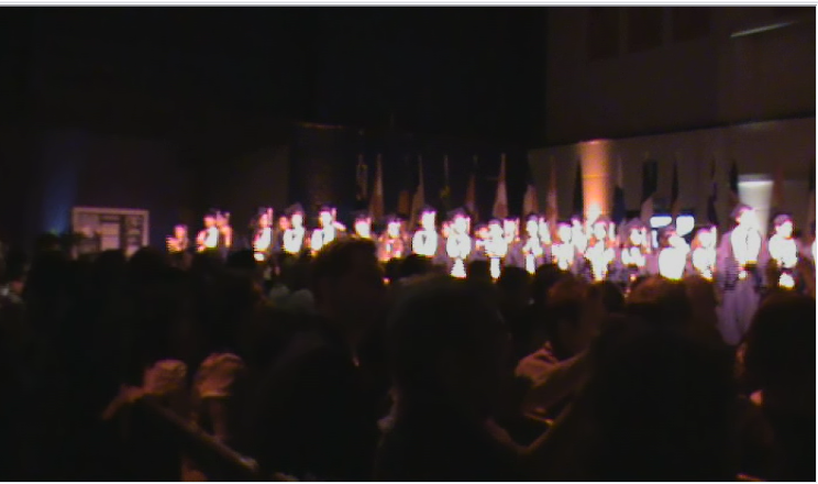

    There are varying mask techniques that can be used in more sophisticated sopftware, but even there you are dealing with this: a frame from your original, no processing. . .
    [Attachment 13244 - Click to enlarge]

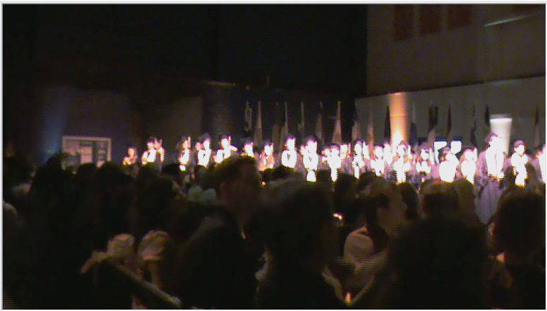

    I used some ColorYUV settings to raise detail in the darks and lower the brights. Then a gradation curve filter to tame some of the red. This works to a limited extent. I think you can, see however, that lowering brights and raising darks did little to bring any detail into those areas. You can use sharpening, but mostly you'll get grain and just sharpen noise. You can't create detail where none exists. The lack of detail isn't a matter of focus; the murky shadows and faceless faces are symptomatic of severe clipping. There's not even enough blue bdfata in the orangy audience to keep highlights from looking discolored, and a few of the "people" details are turning green.
    [Attachment 13245 - Click to enlarge]

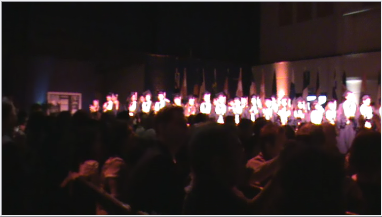

    Using SmoothLevels() to keep luma and chroma within a valid video range and some ColorYUV to tweak things even more, the audience is abandoned and left-as in favor of taming the bright faces and raising midtones. The brightest parts of this image have been lowered to RGB220 or below to try to retrieve some original highlight detail. It just isn't there.
    [Attachment 13246 - Click to enlarge]

    Most members here would do as I did: convert the mpg to AVI with lossless Lagarith compression. I used DGIndex to make that conversion. This AVI was in its original YV12 colorspace. In Avisynth I used ColorYUV and SmoothLevels (part of the SmoothAdjust plugin package). The SmoothLevels() and ColorYUV statements I used to produce the bottom image of the 3 posted above were:
    SmoothLevels(tvrange=true)
    ColorYUV(gain_y=-18,cont_y=-40,off_y=-17,gamma_y=15,cont_v=-70)
    Those were were derived less for color "correction" than to illustrate a point. To view the results of the efforts I viewed the output in VirtualDub using Trevlac's ColorTools RGB histogram/vectorscope/waveform plugin and a gradation curves color filter, the latter used in the middle image, above. The RGB tools are similar to those found in Photoshop Pro and After Effects. Avisynth has useful histograms and other 'scopes, too. But I like viewing all 3 colors + luma in RGB, even though I don't always go to RGB for correction tools. With YV12 or YUY2 sources having bad levels and chroma problems, it's almost essential to correct in YUV first, before moving on to denoising or working in other colorspaces.
