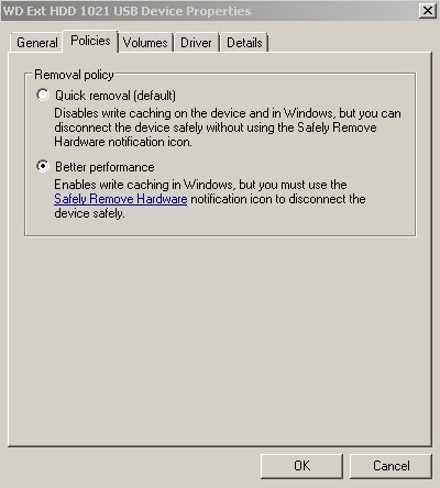

    Often you can improve/maximize the write speed by enabling the write caching option on the USB drive.
    I always do this with my external USB drives, makes quite a lot of difference.
    Windows 7 Forums: How to Enable or Disable Write-Caching for a Storage Device in Windows 7

    ... [insert emoticon for slapping the side of my head] ...
    How in the hell did I forget that?

    Me too had forgotten the damn feature
    But here goes the appropriate emoticon for the occasion:
