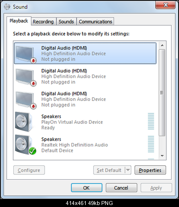

  2. You should set the computer to 1920x1080. Then look for a pixel-for-pixel (non-overscan) mode on your HDTV. You need to install a driver that sends audio over the HDMI connection. It's usually included in the graphics card's drivers. Go to the Control Panel's Sound setup applet and make sure the HDMI driver is set as the default audio output.
  3. Originally Posted by jagabo View Post
    [Attachment 13235 - Click to enlarge]

    3- Regarding the audio, I have the latest Nvidia driver installed. I found a Digital Audio settings in my Nvidia's control panel. From there I chose the LG screen to appear in the audio settings as a playback. Yet the only thing I see in the playback devices (besides the sound blaster card and headphones) is "Speakers - High difinition audio device". Chooseing that as the default device does nothing I see the audio bar moving, but no sound. THe problem is not in the screen itself, I verified that.
    What else, please ?
  4. According to the link you gave your LG HDTV has a non-overscan setting. See Specifications -> Video -> Just Scan (0% overscan). That will get the 1920x1080 desktop to fit properly. And since there will be no resizing it will probably get rid of the over sharpening artifacts. If not turn off all sharpening filters on the TV.
    Regarding colors, what exactly do you mean by "the colors are not correct"? For a start, turn off all automatic brightess, contrast, hue, and saturation filters. Also any edge enhancement and noise reduction features. Both on the TV and the graphics driver's setup applet.
    Was your HDTV plugged in via HDMI when you installed the Nvidia drivers? The HDMI audio driver may not have been installed if there were not HDMI devices connected. Also, when in the Sound applet, right click in the window with the devices and make sure Show Disabled Devices and Show Disconnected Devices are enabled.

    Regarding the sound. yes when I installed the latest driver the HDMI cable was connecting the screen and the gfx card. And I have the "disabled" and the "disconnected" devices shown, but yet no HDMI option.
    I will try reinstalling the driver now.
