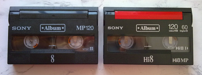

    1- My camera is PAL but the recorded tapes are all labeled as NTSC(I didn’t know it at the time of recording). Now I’m wondering whether the recorded videos are PAL or NTSC? the manual says that the camera is also able to play back tapes recorded in the NTSC video system.

    VHS tapes are universal....I don't see any reason why Hi8 would be any different. I'm betting they are PAL.

  5. The tapes are universal, so if you used a PAL camcorder, the recordings are PAL. The NTSC markings are there to indicate that the running time of the tape is 120 minutes when recording NTSC video. PAL usually records at a slightly slower tape speed, so the tapes likely have more than 120minutes of video on them.
