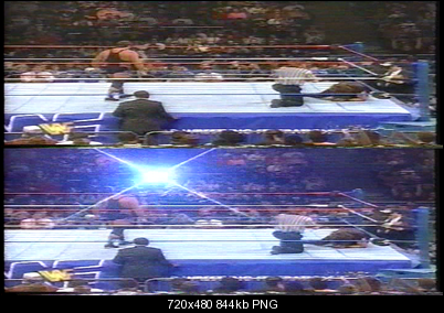

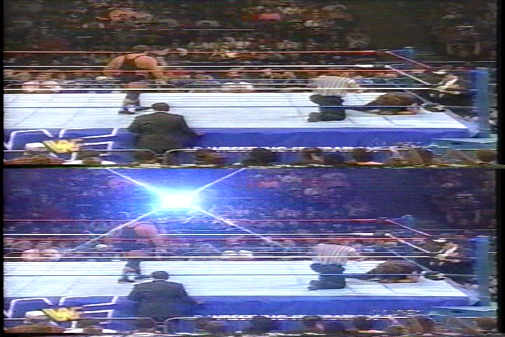

    jagabo; if you've got time, take a look at the Y channel of the video at around frame 73. A flash goes off in the audience behind the ring. Looking at each individual field, the field with the flash seems to show an adjacent field blending with it - the flash isn't uniform and smooth except right at the centre.
    I don't see anything unusual in the frame with the flash -- 72 by AviSynth/VirtualDub numbering. Fields separated and stacked:
    I turned off DgMpgDec's deblocking filters for this sample image so you can see the heavy macroblocking. There's so little motion in this frame how could you tell whether there's any field blending or not? In any case, there's no field blending anywhere else in the video.
    Hmm, I'm using Blender's node compositor. What I'm seeing might be caused by improper handling of the chroma sub-sampled image.
    Your example isn't showing the problem.
