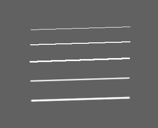

  18. Originally Posted by sanlyn View Post
    I've used the same simple bob with properly interlaced and progressive source. Yes, it always looks a little sci-fi, but I don't see jaggies, smearing and geometric tricks like these. If you filter this clip as if it's interlaced, it looks worse. But running QTGMC in repair mode makes significant improvement, to the point where other denoisers actually accomplish something afterward. The last time I saw serrations and wiggles like these after deinterlace, it was because I did something silly. Now, I can't recall what my error was. But it produced similar effects. Unfortunately I don't have the original VHS source to re-work. Only have the botched results. Anyway, I'll keep at it.
    Whenever you have sharp, near horizontal lines/edges, you get artifacts like that with a simple bob. Think about what a simple bob does -- it takes one field and fills in the missing lines with data interpolated from the line above and below, then does the same with the next field. When you have thin horizontal lines they end up jaggy. What you are seeing is perfectly normal for a simple bob deinterlace.
    Thin horizontal lines:
    Bob deinterlaced:
    Smarter deinterlacers will look at other fields, and other frames, for data to fill in those missing lines. And perform smarter interpolation methods (like nnedi3).
