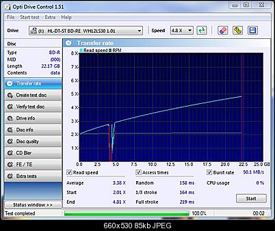

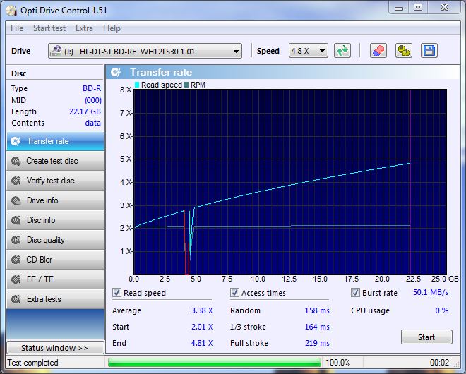

    I've stated before that Blu-ray discs are by no means immune to scratches. Well, I finally decided to test it definitively.
    I just retrieved a disc from the trash, a backup I did a few days ago, but had printed the wrong label on it and had to do over. I put a deep scratch on it with a penknife, about 1/4 inch long radially, deep enough too feel with your finger. Then did a transfer rate (read speed) test on it with OptiDriveControl.
    Here's the screenshot:
    I fully expected the disc to become unreadable at the scratch. No such thing.
    This makes me wonder why those ex-rentals couldn't be ripped, with much less obvious scratches on them. I guess I'll have to try putting a scratch across the disc now, rather than radially.

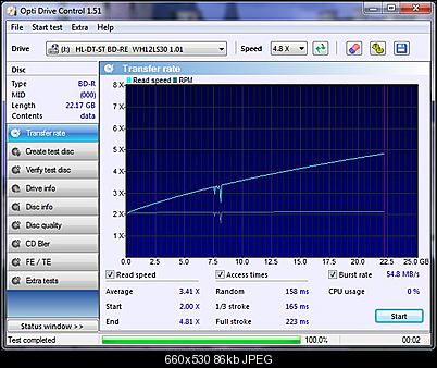

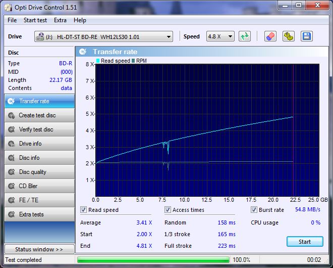

  4. Okay, I take it back, ripping is not a reliable test.
    Here's a screenshot of a transfer test after another, deep crosswise scratch:
    Anyone care to explain why the first, radial scratch doesn't appear on this scan? Anyway, surely it won't rip, right? Oh yes it will. It got perilously close to 0.0 MB/sec read rate, but it got through the scratch and ripped alright.
    The rip shows lots of bad glitching right where you'd expect, for about 2 mins, starting at 23 minutes into the movie. Played with Arcsoft TME (Digital Theater). Oddly, the disc played with less glitching in my LG standalone. If I wasn't paying close attention, I might not have noticed.
    I know, this was a recordable disc, not a pressed disc. Maybe that would make a difference, but I'm a little surprised. BTW, the disc was a CMCMAG_BA3_000, burnt at 4x.
