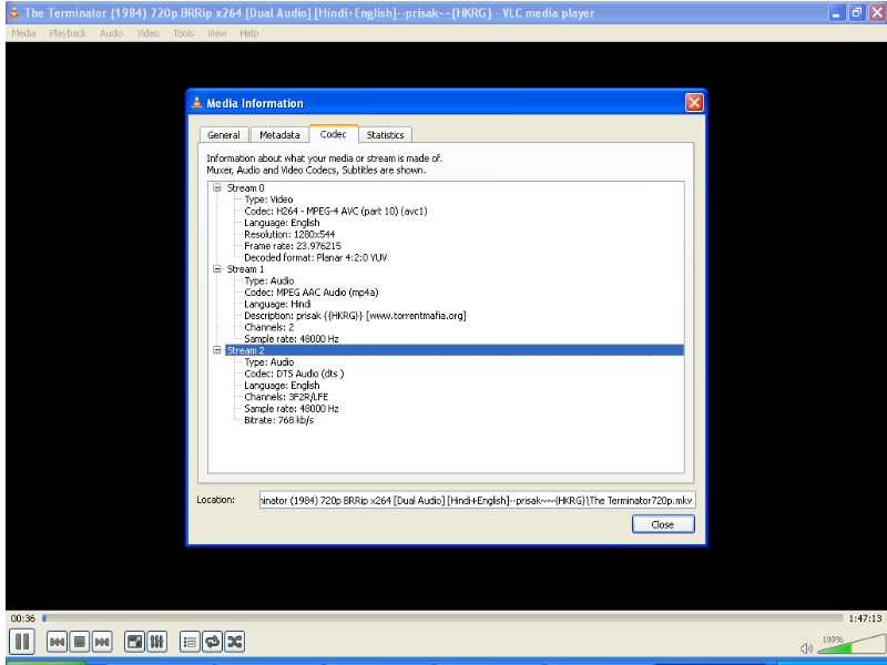

    how can i check the audio? if i open the file in vlc player will that tell me what i need to know?

    You should use MediaInfo for this but from that screen shot the first audio track appears to be AAC and the 2nd appears to be normal DTS.
    From your explanation the 2nd track isn't playing on your Tablet so I guess your Tablet doesn't do DTS audio. So you will have to convert it.
    I would use rebox.NET which is a simple program that will convert this to a MP4 file. Basically it will NOT re-encode the video but will re-encode the DTS track to AAC and then it should play fine on your Tablet.
