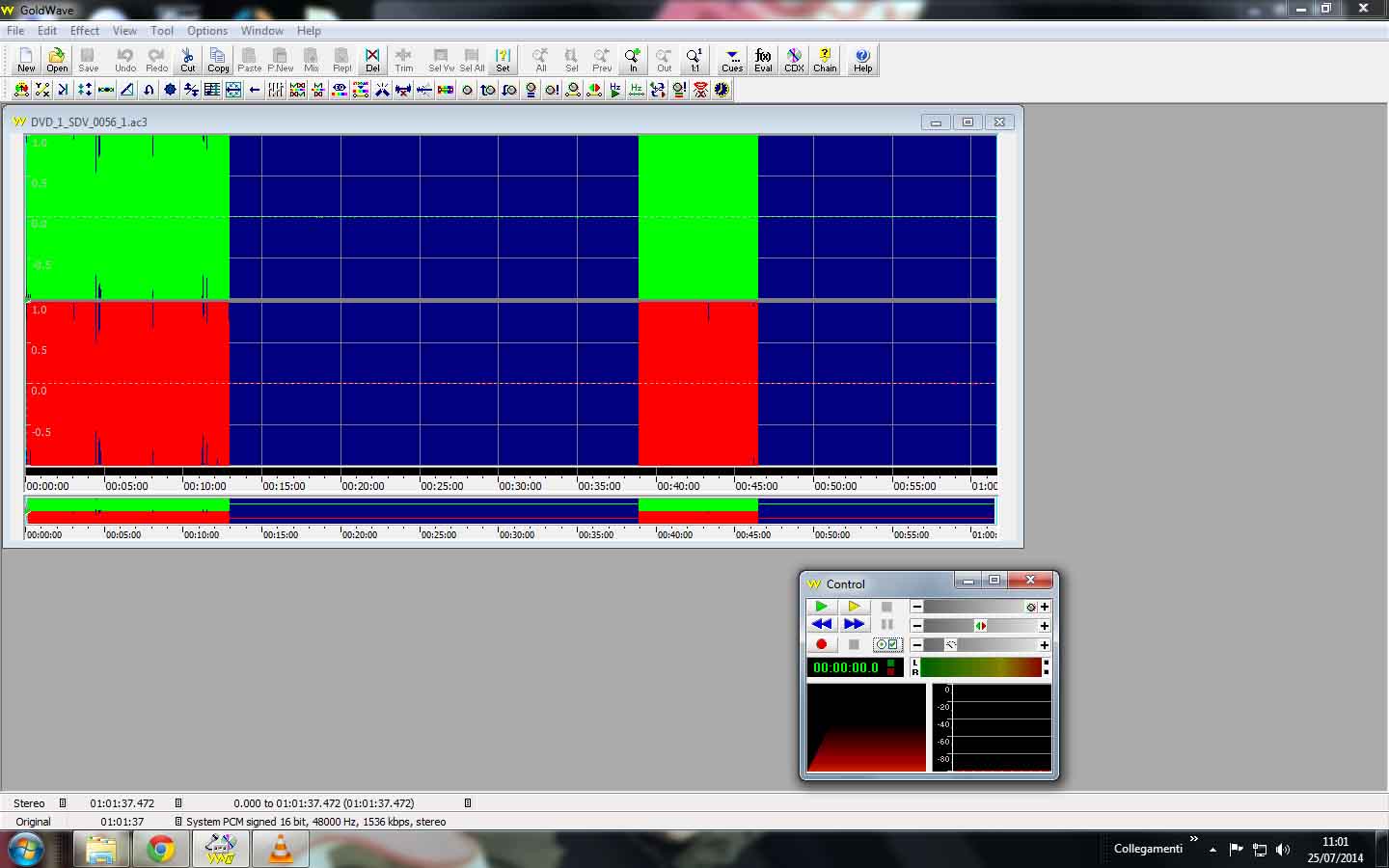

  9. Any advices on how to set my audio?
    Now every time i try I get a perfect video (using the settings we talked about earlier in this thread) but the audio is always ****ed up (totally sped up with a lot of silence in the middle, see attached pic). Tried different settings but still faulty.
    The attached pic was obtained like this:
    Audio Source Filter: FFMpegSource
    DVD Audio format and bitrate: AC3 224 kbs
    AC3 Audio encoder: FFmpeg (avisynth)
    Any suggestions would be much appreciated!

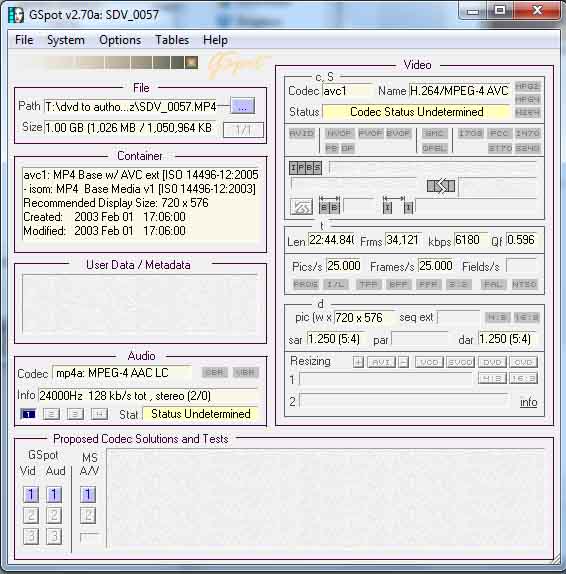

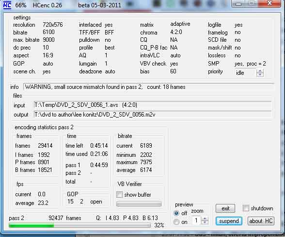

  10. More problems. I'm trying to make a dvd from MP4 files of another concert I shoot with the same camera. The audio problem is still there, same as my previous post, plus I got a video problem during the second pass of encoding (see attached pic. This same error happened at 72% during my first try, 32% during the second).
    I'm attaching a screenshot of the error, the log I got from AVStoDVD and a screenshot of the specifics of the source file.

    Not sure about the audio - any clues in the A2D log? Regarding the message in HCenc - Warning, small source mismatch.
    It can be resolved by setting FFmpegsource for the video source filter.
  12. Why don't you try to input directly the source file, without going thru an intermediate avs file. You can tweak the avs file also in AVStoDVD. 'Edit Title'/'AviSynth' tab.
    After you have added the original video file, use the 'Codecs'/'Build DirectShow Filters Graph' to see if there are some issues in the (audio) decoding chain.
