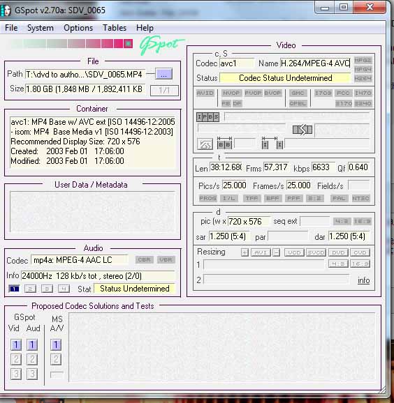

    Here you can see the specifics (from Gspot) of a file recorded by my videocamera, so you can figure it out better:

  22. The original source it's very big Mp4 files, i don't know how can i take 10 seconds of it without reencoding i will post here.
    I'm feeding them as an avisynth script because it's 3 files, the script joins them as one single bigger file. But I also tried to make the conversion without the script, just leaving the 3 single files, and the rsult was the same
    I'm attaching the GSpot specifics of one of my source files.

  25. Definitely interlaced PAL.
  26. How could i solve this?

    The problem appears to be that your mp4 header incorrectly identifies the video as progressive and the aspect ratio as 5:4.
