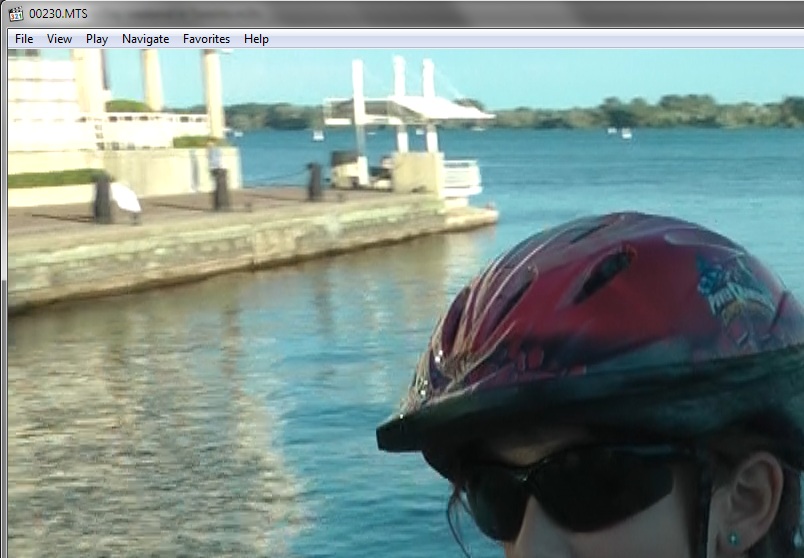

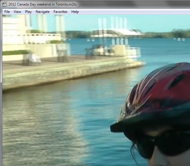

    I have been using AVS4YOU Video Editor to edit videos made with my Full-HD camcorder (Panasonic HDC-TM700) and save them as Full-HD video files on the hard disk. Scenes with motion or panning appear somewhat fuzzy/blurry in the output (produced) files while in the source files they are perfectly smooth. Frame by frame comparison shows that in the output file each frame appears to be composed of two source file frames, which I guess blurs the motion. I am attaching screen shots of the same moment from the source and output files.

    What immediately jumps at me is that the output file is progressive vs the source file's intelaced. However, using the Deinterlacing effect in AVS4YOU had no effect on blurriness.
    The default output of such camcorders is indeed interlaced. Deinterlacing to create a progressive frame out of two unique fields can take many forms, though: display both fields at the same time, drop one field and repeat each line in succession of the remaining field, drop one field and create interpolated new lines, create a new frame by intelligently interpolating line pairs from the two fields, efficiently create a new frame by sensing the differences between fields and applying different algorithms, etc. AVS4YOU may be deinterlacing but if it's doing it with the 1st method I mentioned then this is just plastering one field over the other therefore showing bluriness in scenes with a lot of motion like that you observed. Can you choose deinterlacing method in AVS4YOU? If done with the 2nd method, bluriness will be gone, but this effectively halves vertical resolution and is wont to produce jagged edges on slanted lines in the video. The other deinterlacing methods will take longer processing times and more computational power but reduce if not remove the bluriness and maintain original vertical resolution.

  3. as turk690 says, you are blend deinterlacing
    The other option is to export 1080i60 (ie. same as original) .
    If that editing software doesn't allow for better deinterlacing or export options it's time to use other software
    Your camera shoots 1080p60 - why aren't you using that mode? (then you don't have to fiddle with interlace/deinterlace or fields)
