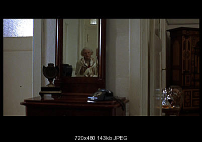

    This is a frame grab off the original clip:

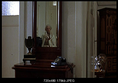

    This is what I want it to be:

    The original clip is from a 1999 DVD, which, probably taking a cue from LaserDisc just before it still presents everything in 4:3 (letterboxing widescreen sources). I simply want to upscale the image by 133% (in a widescreen NTSC DV AVI Premiere project setting), which eases the black bars off, and encode to anamorphic widescreen DV AVI or MPEG elementary stream. Note that it's true-blue 4:3 and the sides do not have black bars. I have a number of pre-2000 DVDs like this which have never been re-issued commercially. Anamorphic 16:9 wasn't in vogue then and I can and do remove the black bars with the method I have used in Premiere I mentioned above. Premiere mangles the upscaling and I lived with that, until I came upon and used the hd2sd and sd2hd avisynth scripts on unrelated HD projects and saw how clean and sharp up and downscaling can be if avisynth is the one that does it. I want the same for the clips from these DVDs, which is SD, and that is how I titled this thread.
