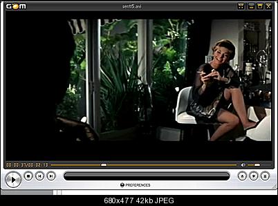

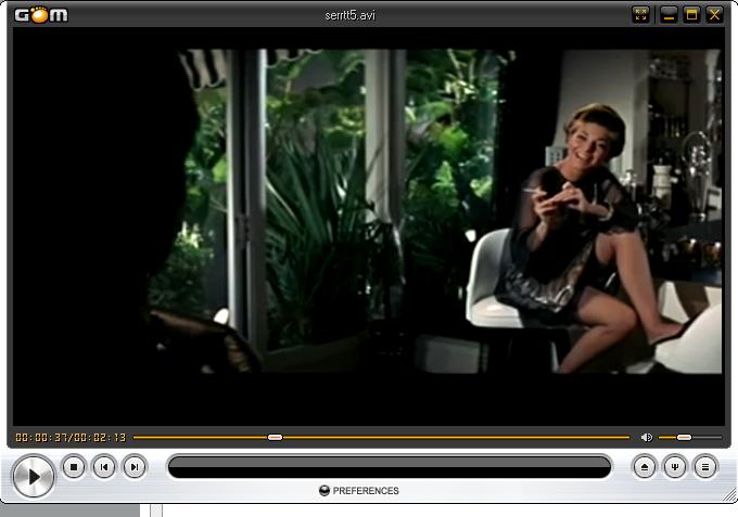

  25. Click image for larger version
    OK, here you can see an image of the "complicated part", the part with the worst horizontal pillars... Thatīs whatīs left of them after the cut, because they were really big... ) But the image proportions donīt look bad to me... And the rest of the video doesnīt have any black pillars almost.
    So... Whatīs the conclusion? I am a bit confused... )) Itīs not distorted.
  26. Originally Posted by Valerc View Post
    "horizontal bars" is letterboxing (horizontal bars on top & bottom) => this means content is wider than the display
    "vertical bars" is pillarboxing (vertical bars on left & right) => this means content is narrower than the display
    If you had letterboxing (horizontal bars), and you enlarged the image, you are trying to convert to a 16:9 display, but you lose the edges of the frame (you lose active pixels)
    It's impossible to say exactly unless you provide more information or sample clip, because the bars might be encoded into the frame, or they might be added on display, or some other combination . How it looks on youtube might look different than on your media player

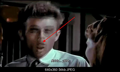

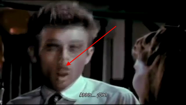

    Ok, there are some other problems : do you see the horizontal lines when there is motion or people move ? - that's combing. The source you have probably didn't inverse telecine correctly. There are also some stuttering from repeat frames

    With stutter do you mean like the James Dean part? Itīs the weirdest to me. His face looks like melting at some point... ) I have just seen the original source and it was like that too. I also didnīt like it, but...
    The horizontal lines donīt look so bad to me... But how would you improve that? I think that the main problem is that the material is diverse, with diverse quality.
    The stutter is on the street scenes every few frames is a repeat
    It might be that you set the composition to 29.97 (film is 23.976) , so whatever program you used is adding repeats
    The other sections should be 23.976, but probably weren't IVTC'ed, so you see the combing
    It depends what the source content was. But it looks like it wasn't processed ideally, there might be some things you can do to improve it, but it's impossible to say without looking at the source material or having more information
