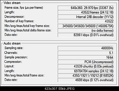

  4. Click image for larger version
Name:	file information.jpg
    This is the information that virtualdub has on the file.
    I attempted 6channel compression with AC3 and got the first error in my original post again. Also I am indeed using Virtualdub to convert the file, which is what give me the "Cannot convert audio: the source channel count is not supported (must be mono or stereo)." This error is happening if I change /any/ of the options, alone or together, that are provided in Audio -> Conversion... in Virtual dub.
  5. I think VirtualDub only supports mono and stereo audio in full processing mode. You'll have to downmix to stereo before giving the audio to VirtualDub or use some other audio software to compress the audio, then import it into VirtualDub in direct stream copy mode.
  6. Yeah, it seems like even when I just allow it to not process the audio from the original video, it becomes extremely chipmunk-ish and crams the entire audio stream into the first few minutes. So even if I ignore the audio and compress only the video, I have this issue.
    What program would you recommend, jagabo? I just attempted to do it with Avidemux, but even though it says it works, the video always comes out in 6ch again, even if it says it will change to mono or stereo.
