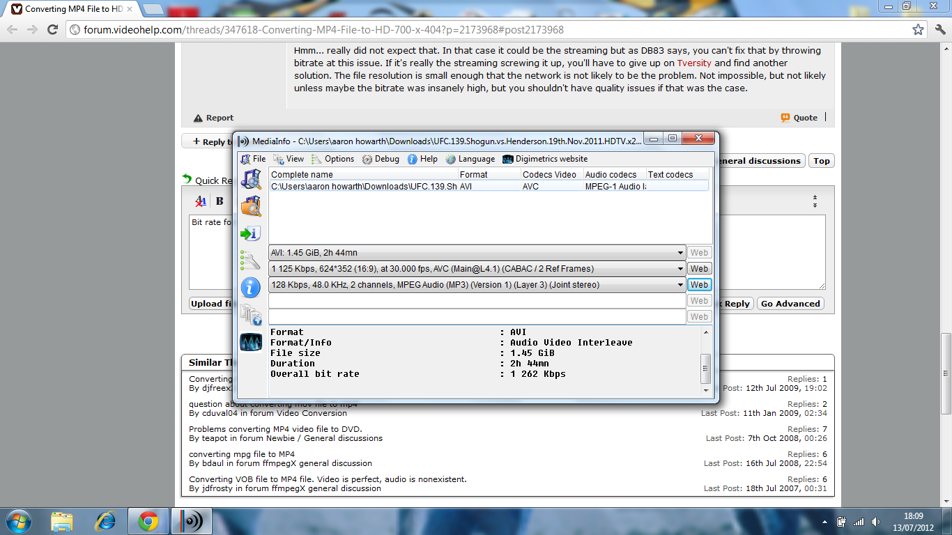

  9. Bit rate for the file is "1 262 kbs" ?
  10. Member DB83's Avatar
    Jul 2007
    Is this the same video ?
    The dimensions are NOT as you described them in the initial post.
    So maybe that streaming software changes the dimensions as well. Not good.
