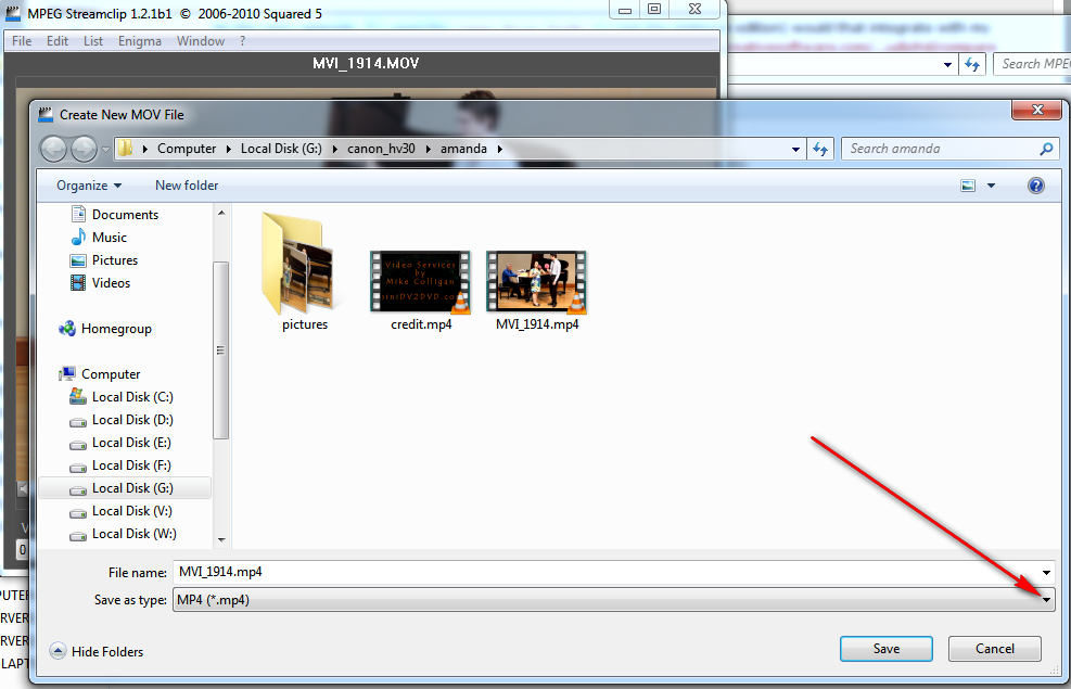

    never heard that one. even if it does there are plenty of other ways to convert to mp4. MPEG Streamclip open file then save as mp4.

  5. MPEG Streamclip - when you load a MOV file it has a dialogue box with various options to convert/save the file to the new format (MP4). Should you let it select the options by default or does one need to change the settings. I only altered the "quality" setting to 100% in lieu of the 50% it had selected. I do not want to loose any quality.

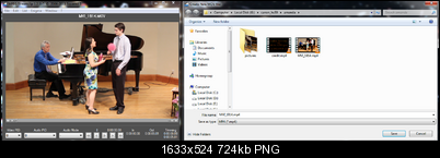

    don't do anything but run streamclip, file/open the mov, file/save as, and change the output to mp4 by clicking the little arrow and choosing mp4.

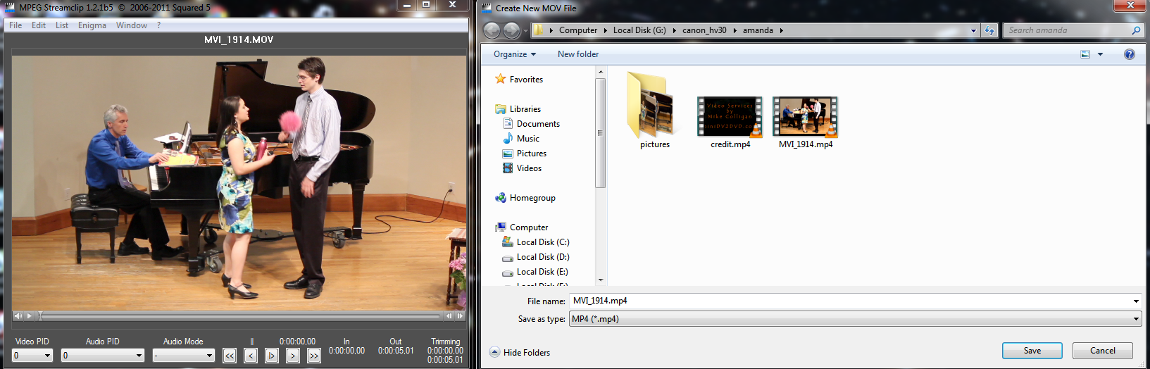

    what??? are you following the instructions given? prey do tell where in this picture is a quality slider?

    don't use export. click file - save as, and change the file type to mp4 as instructed and there is NO change in quality or any re-encoding. it is just re-wrapping the file in a different container.
