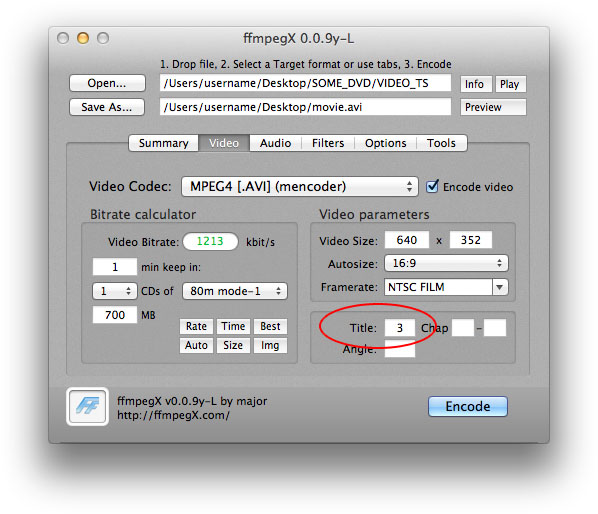

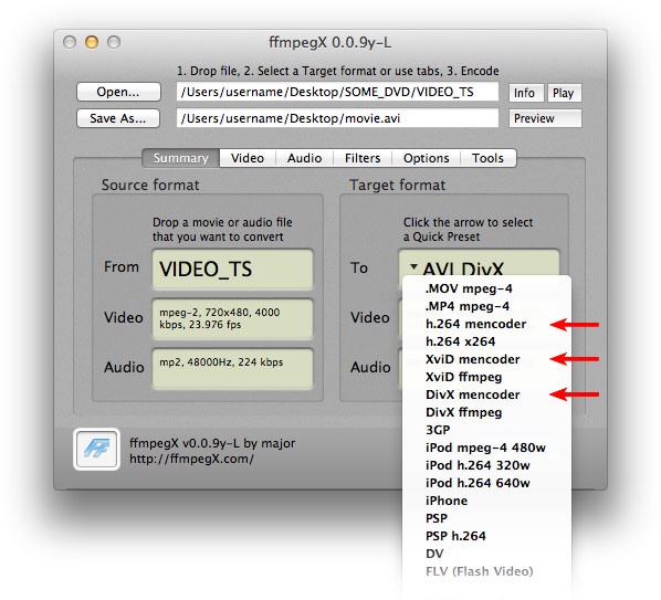

When you want to convert a DVD to DivX (or XviD) with ffmpegX, you either --
1/ Drop the VIDEO_TS folder on ffmpegX and convert with a mencoder preset, and set the desired title, or
2/ Create an MPG file with just the content from the desired title, and convert that with any preset you want.
Notes:
- VTS_03_0.VOB through VTS_03_8.VOB doesn't necessarily mean it is title number 3 on the DVD. It often is, but the DVD specification allow for these numberings to be independent. View it on a player that shows the current DVD title being played, and note that down.
- VTS_xx_0.VOB (zero-vob) should contain menu stuff (video or stills), not the actual feature. If you want to included it, it may not work in one go. The actual feature would be in the sequence of VOBs from VTS_xx_1 on.
