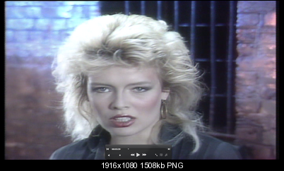

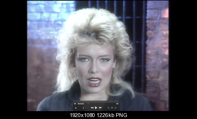

    I have some DVD's in my collection that aren't played like they should be. The original video has an aspect ratio of 4:3. But when I play it in a DVD player, the video is stretched out to a 16:9 aspect ratio.
    This doesn't bother me when watching a movie on DVD. The only thing I have to do is set my TV to 4:3.
    But what to do if ripped DVD reacts this way? Is there a way to convert VOB's to MPEG2 while changing the aspect ratio from 4:3 to 16:9?

  3. Originally Posted by HitTheRoad View Post
    I thought you wanted to set it to 4:3 but it played as 16:9? That's what your picture shows. Anyway, the DAR (4:3 or 16:9) is usually set in the IFO. The VOBs are (usually) the same in any case, 720x480 or 1.5:1 (for NTSC). The DAR can easily be changed by using PGCEdit. Open the DVD while it's on the hard drive, right-click on the video in question and hit 'Domain Streams Atrributes'. In the new screen change it from 4:3 to 16:9 or vice-versa. Save your work and test out the DVD before burning it back to disc.
