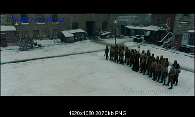

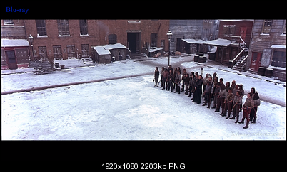

    But sometimes things are clearly out of whack. You can't tell me Scorsese signed off on "Gangs of New York" remaster . Of course this is a relatively newer film, and he's very much alive
Name:	blu-ray remaster.png
    You can see more pics and discussion here
    http://www.avsforum.com/t/1045420/gangs-of-new-york-comparison-with-remastered-version-update-pix

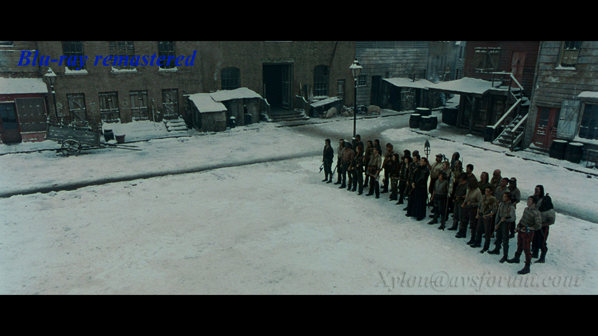

    Poisondeathray makes some excellent points. Pricey software can do things that with free tools are possible (some of it, anyway) with free tools, but extremely difficult to accomplish. And the learning curve with sophisticated tools is something else: I've had AfterEffects Pro for 7 months -- I'm still learning details of the interface, forget about motion tracking!
    Still, we poverty-stricken hobbyists can make improvements. And as pdr says, everyone makes decisions about the look they want. There are both subjective and objective considerations. Objectively, you'd want a video to comply with accepted level and color standards; A video that's blindingly bright or has crushed darks gives encoders a rough time and will look worse on TV. In the two images above, the top image is too blue and has clipped brights; the bottom image is too green and dim. Doorways and some shadows, even though dark, look foggy. As an example of how histograms are used to analyze level and color problems, here are 4 histograms of the top (bluish) image. I used Photoshop histograms here (in this case, they are easier to read), but you can ascertain the same problems with Avisynth or VirtualDub tools:
    Top image histograms: RGB (overall luma), + Red + Green + Blue. At the right side of the histoghram, note howm the graph smashes against the right-hand wall with RGB, Green, and Blue clipped:
    [Attachment 13075 - Click to enlarge]
    Depending on the impact or impression you want to make with this scene, level and color corrections make a difference. Below is a quickie using VirtualDub's garadation curves plugin. Here, I chose to target natural looking colors under an overcast sky. You might like to see the scene another way:
    [Attachment 13076 - Click to enlarge]
    Keep in mind I'm working here with captures, not with the source. That in itself has its limitations.

    Yes, I don't know where that purple is from. But since the samples aren't from the source, I made quickies to show the "free" possibilities. The discoloration is from a Blue peak around RGB 220. But I agree, I'll bet that purple in the original (or in real life) would be yellowy. Material like this is good study fodder for learning AfterEffects and Color Finesse. I paid enough for it, I may well learn to use it.
