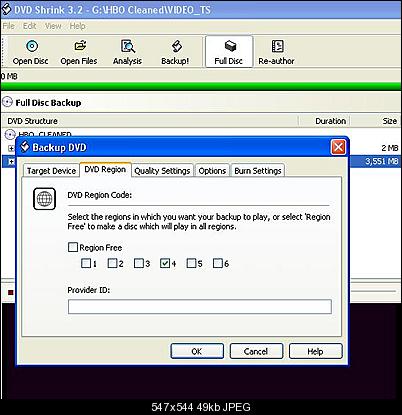

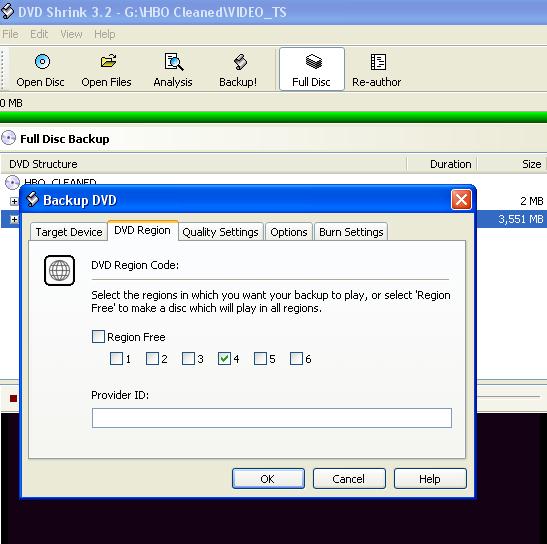

    Yep....DVDShrink is the only one I know of that can manually assign a region to a disc.
