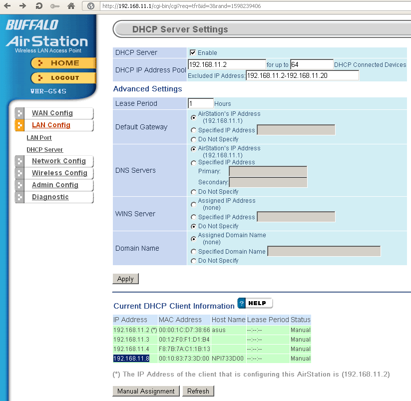

    Here is my page.
    The "DHCP pool" is the range of addresses controlled by the router.
    "Excluded addresses" are in that range, but ones not allocated randomly. These are ones I choose for my devices, my PC, laptops, phones, printers.
    The "Current DHCP Client Information" shows what is now connected.
    My printer is the last one,
    IP: 192.168.11.8 MAC: 00:10:83:73:3D:00
    You can work out which is which by turning the device off and seeing what changes here.
    I used the "Manual assignment" to give my printer the fixed IP 192.168.11.8
    It's identified by the MAC, a hardware serial number.
    If you're not comfortable playing with your router, you may need to get someone to help set this up.
    Then the printer will always have the same IP and so your printer settings will always work.
