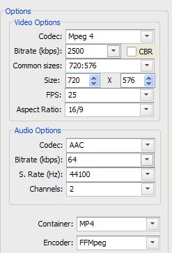

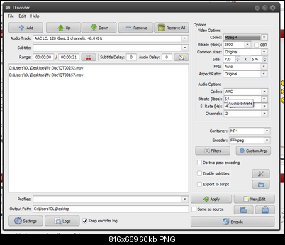

  2. How about trying another video conversion tool? I started out with the free version of Any Video Converter, which accepts .mov files. You can also try TEncoder using the settings in the attached image. I recently tested TEncoder converting a .mov file from my Zx1 and the resulting .mp4 file plays in VLC version 2.0.2. Maybe this may work for you?

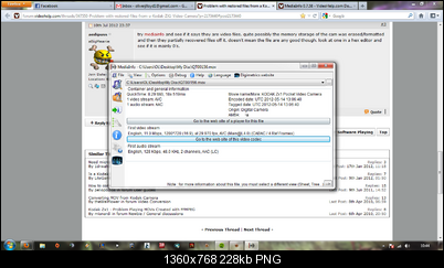

    try mediainfo and see if it says they are video files. quite possibly the memory storage of the cam was erased/formatted and then they partially recovered files off it. doesn't mean the file are any good though. look at one in a hex editor and see if it is mainly 0's.

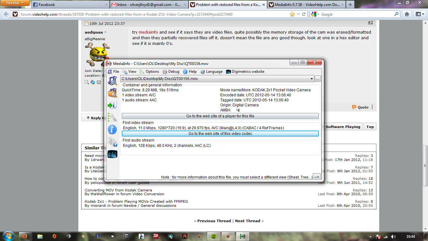

    Hi guys, firstly, thank you for the responses. The above screenshot shows the information from Mediainfo, which clearly shows it has an audio track as well as a video track.

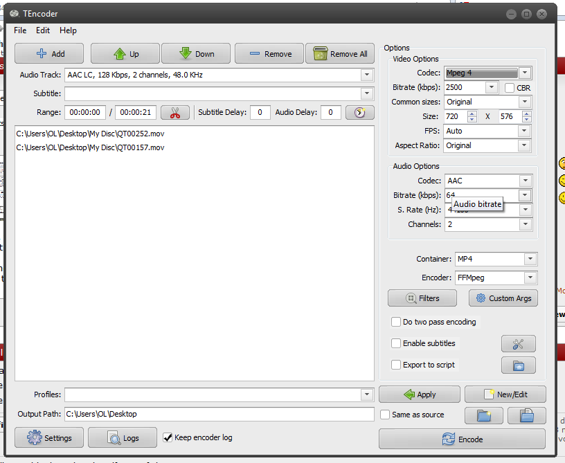

    As for the other post regarding another coverter, I downloaded TEncoder and using the settings below, I was able to convert the files. However, same thing happens. I get a singular image for the videos entirety within Quicktime.

    looks to small to be complete video file. the one you used mediainfo on is listed as 8.3MB which is 66.4mb. the bitrate listed is 11mb/s and a length of 18 seconds which would create a file of about 200mb.
    to get more info from mediainfo put it into text mode, then you can copy/paste all the info here.
    since the file is only 8MB you can upload it here and let us download it and take a look at it if you want.
