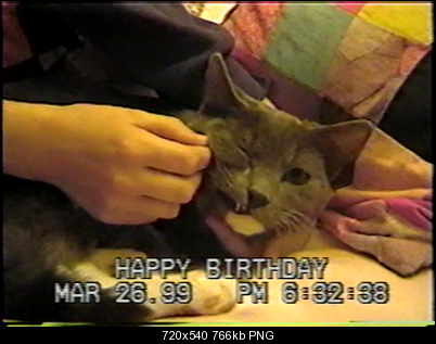

    Here are some screens of my capture quality:
    This is the live capture directly from camcorder that's hooked up to the card:
    And this is captured from the camcorder playing back one of my VHS-C tapes (which were recorded on this same camcorder years ago):
    Notice the line at the bottom of the screen... it's turquoise in this image. It is even partially visible on the burned DVD. This line is not present at the live video. Also, notice all the stretching/tearing all over the screen, and compare the blurriness of the text. Also notice the fuzzy edges where the visible video meets black... they are not fuzzy on the live video though.
    ALL this is NOT present when I play back the tape on my TV either directly from camcorder or from VCR. The video looks sharp and smooth and no blurriness or stretching/tearing.

    That is head switching noise. It is present on all VHS tapes. It's worse on some decks than others. You don't see it on TV because TVs overscan the image -- the outer 5 percent of the frame (on each side) is not visible on the screen.
    I see normal interlaced* video. If you make your DVD correctly you won't see the comb artifacts on the TV. You will continue to see some horizontal jitter because you don't have a line time base corrector.
    Tape has much less bandwidth than the VHS deck's passthrough electronics. On tape VHS has a luma resolution of roughly 360x576. Chroma resolution is about 50x288.
    * With interlaced video each digital frame contains two half images, 720x288 with PAL video, one in all the even numbered scan lines, one in all the odd numbered scanlines. Each of those images comes from a different time and are meant to be viewed individually. So when you view the two images together as a frame on a computer you see comb artifacts.

  9. Also, your sample image has been improperly resized so that the two fields cannot be separated and displayed individually. Make sure that you are not resizing prior to encoding.

  11. I think the resize was done by the software you used to save the image because it is 720x540 -- a 4:3 frame size. But you should capture PAL video at 720x576. Upload a short clip with motion.

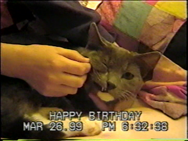

  15. That looks about normal for a capture from a consumer VHS deck. It's 29.97 fps interlaced (59.94 fields per second), top field first. If burned to DVD properly it should look pretty close to playing the original VHS tape.
    The horizontal jitter can be reduced with a line TBC. The bitrate is a bit high for DVD. Bitrate Viewer shows an average of 9384 kbps but peaks are over 10,000. I'd set the PVR-150 to a slightly lower bitrate if you wan't to burn to DVD without reencoding. The noise at the edges of the frame is normal. You can overwrite it with pure black borders. But doing so will require reencoding and will reduce quality. You won't normally see the edges of the frame on TV. Levels look a little off (a little black crush) and colors are over saturated and have a yellow shift (mostly because of the lighting and lack of white balance on the camera). There's a typical amount of chroma noise for VHS.
    Here's what I get with VLC in Yadif 2x deinterlace mode:
    No comb artifacts.
