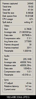

  1. Hi. I am capturing a video that the first 15 minutes have stability problems (image going up and down). Since I can't afford a quality TBC like Datavideo TBC-1000, I have to deal with it. The problem is that when I am trying to capture this part, fps at VirtualDub are dropping below PAL 25fps:
    It causes the video to be sorter than it really is, it actually is 19:01 minutes but the capture with VirtualDub is 18:38 minutes. If I capture it with my card's MPEG2 program there isn't any problem but the quality is low.
    Is there any way to force solid 25fps?

  3. You can set VirtualDub to insert null frames when it detects a missing frame. Capture -> Timing...
