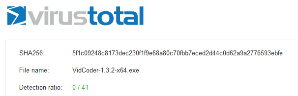

  14. aedipuss: I downloaded VidCoder and I get a security warning that the program doesn't have a valid security signature. Thanks for your advice, but I think I better not install the program when I am getting this warning.
  15. aBigMeanie aedipuss's Avatar
    Oct 2005
    666th portal
    that would be unique. it's clean.

  16. Free software doesn't come with security signatures since the author isn't going to pay for it. Not having one isn't anything to worry about. Just be sure you download from a reputable place and run an AV scan.

  18. aedipuss: I downloaded Vidcoder the 64 bit version. I scanned it with Norton Anti-Virus and it has come up clean. The interface is simpler and I have been able to set a preset that the program remembers.
