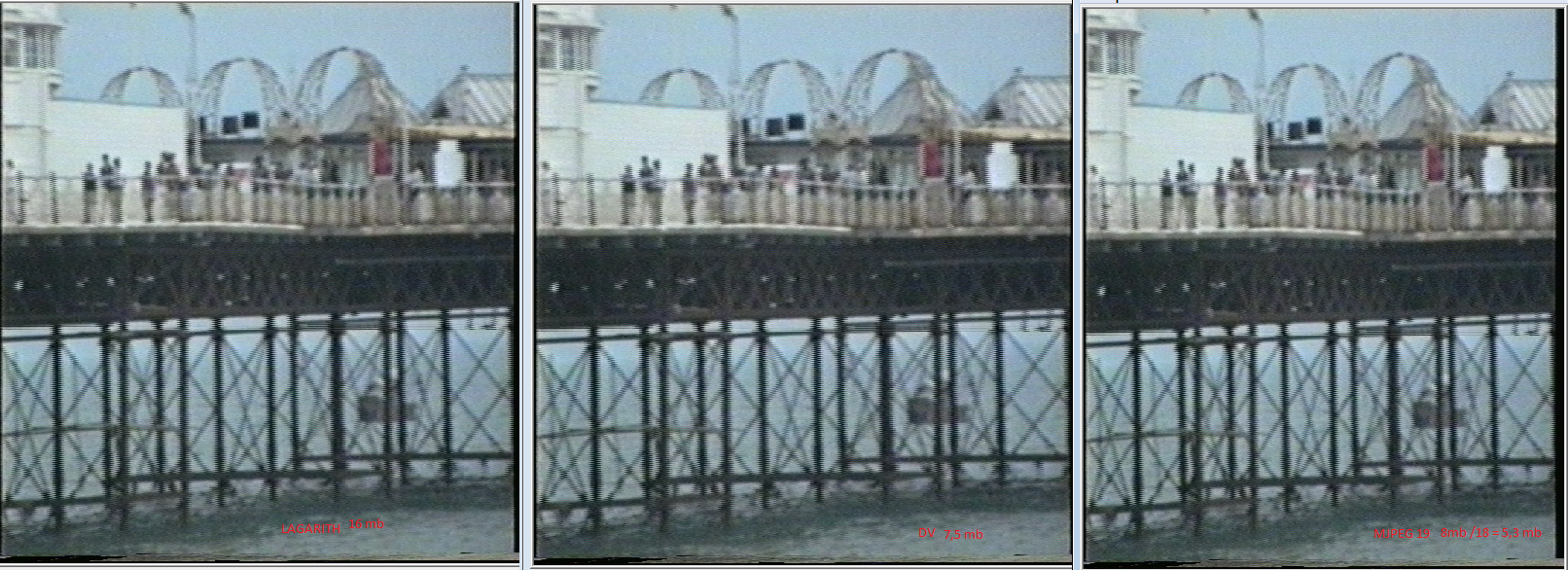

  1. Hi guys is it "smart" to keep copy of captured video in mjpeg format. I made some comparation between lagarith, dv and pic video mjpeg ( settings 18 and 19 4:2:2). The original file is lagarith pal i know that i will loose quality but visually they are almost identical and i need space on hdd to keep all the files for now ( don't suggest me to buy hdd or such). The intention is to have the file as close to the original as possible ( without noise reduction or any processing prior to compressing for further processing. Ideally i will keep the lagarith or huffyuv file on the hdd but as i sad i don't have too much space and dv and mjpeg compress almost the same ( on 18 mjpeg even better more then 3 times less than lagarith file ). By the way the files are already processed ( filters noise reduction and so on ) to DVD ( 60-80 min per dvd) and mkv's ( very high bitrate and full d1 res) but i want to keep less compresed copy and to delete lagariths to open space to more captures that will follow. The reason i chose this 2 codec's is they are very easily editable and ok on quality is also the mjpeg keeps tff and dv is always bff ( so i think is plus). Is this ok or do you guys suggest anything else x264 ? mpeg? or else ?
